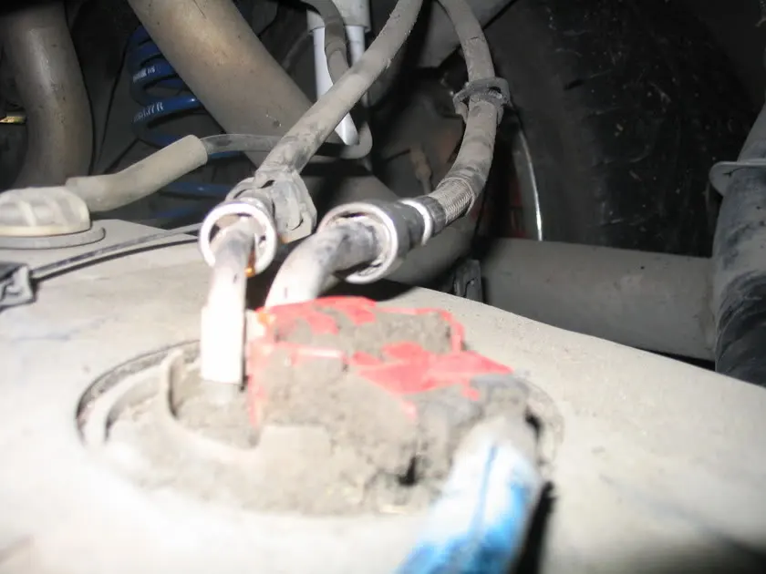

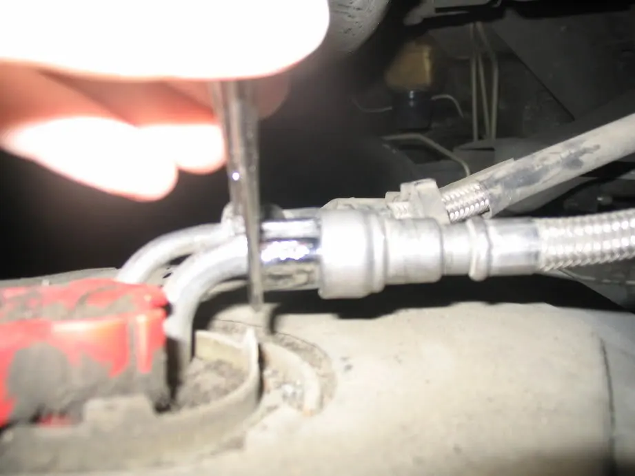

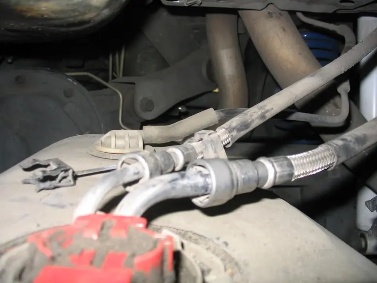

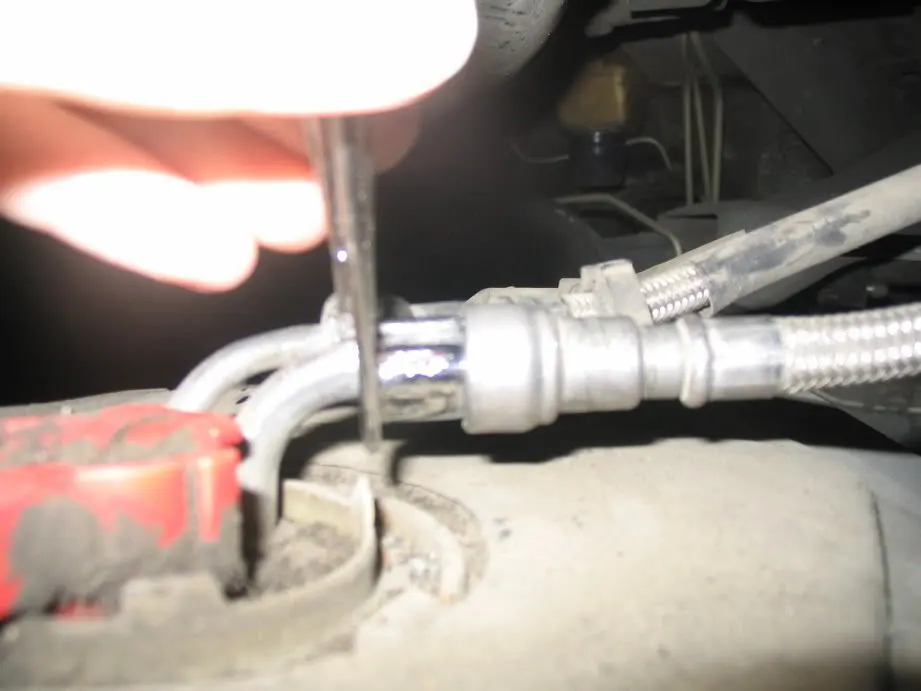

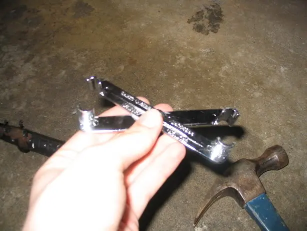

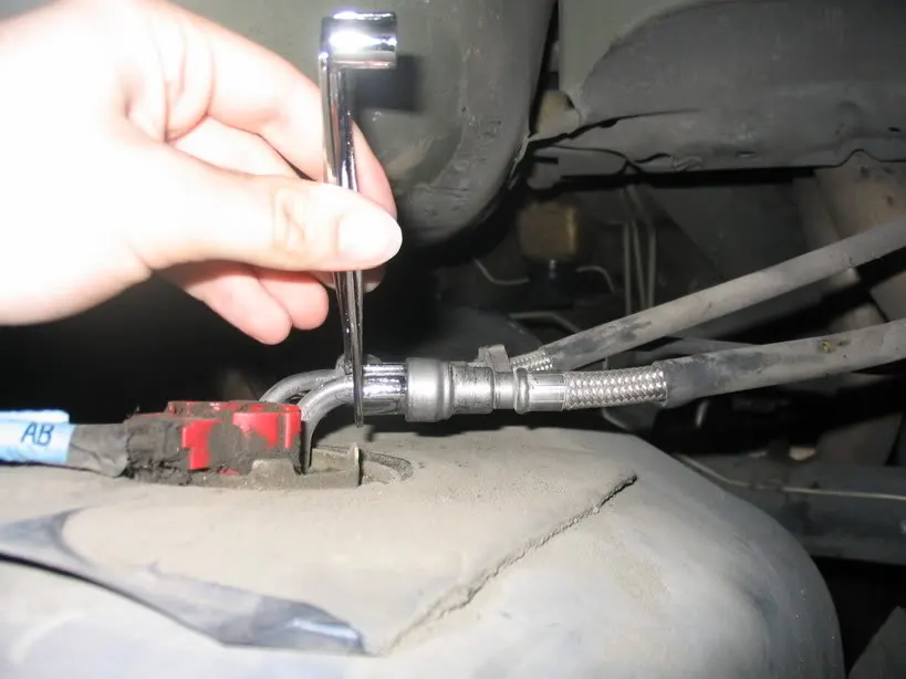

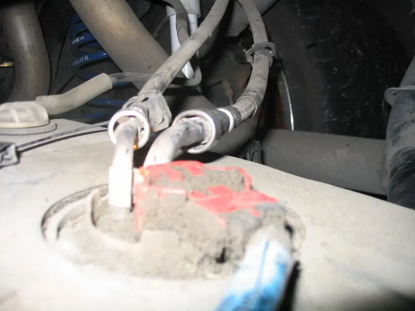

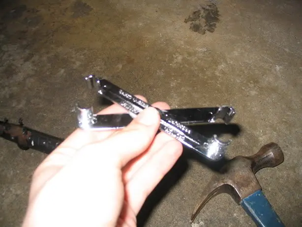

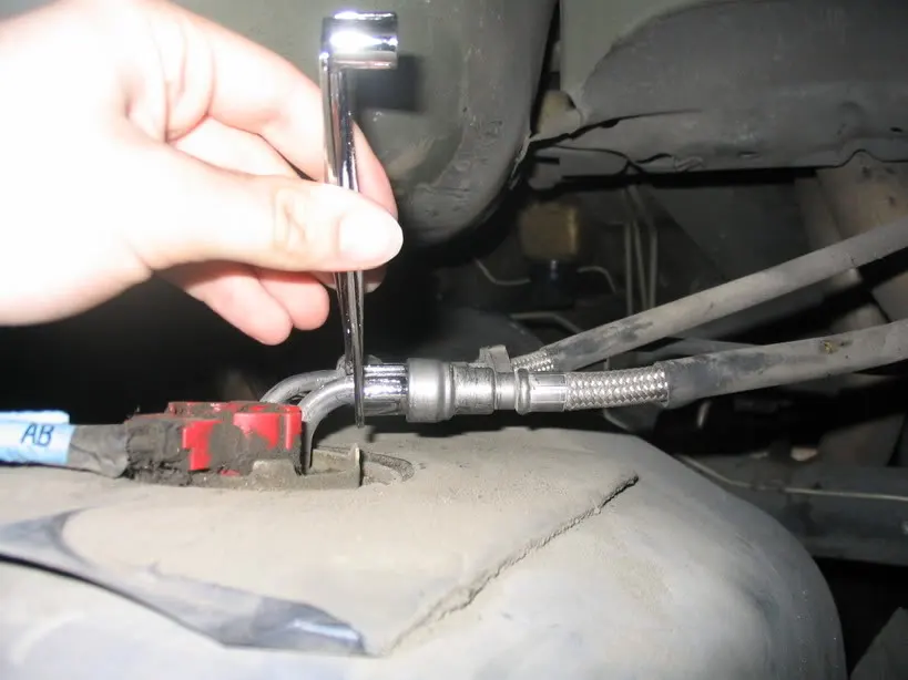

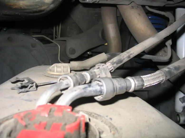

well my brother and I are trying to change the fuel pump and we have gotten everything but the two fuel lines on top of the tank off. We have a quick disconnect tool but cant figure out how to get the lines off. I have a couple manuals but they say almost nothing. heres a few pics off what we have. does the tool slide into the back like i did????? any help would be appreciated, thanks

Yea those fuel line tools are pieces of crap! I know, because I tried using them when doing my heads/cam swap. I never could get the fuel lines off the fuel rails. I finally said fawk it and just laid the rails off to the side. TTT for ya.
Yeah like Black95GTS said. I used the plastic ones, which werent the best ones to do the job. The 2 sizes that you need are 5/16 and 5/8. But they were hard mofos to disconnect. My buddy was pushing the disconnect fitting in the line with pliers while I was pulling as hard as I could (from the wheel position) and we finally got them out. Try a small flathead screwdriver also to disengage the lines. That could work. Good luck.
I could get the tool to work on the large line, the small one was no dice...At this point , since your into it....I would use small screwdrivers to push the tabs back, and give the line a tug....you can see the tabs right in your pic....dont push the way back, you could break em...
I had better luck using the White plastic ones versus the metal one like yours...I found those to be little bastards to undo...:D

The little round white plastic tools like in the right side of the pic have always worked pretty good for me. :nice:
