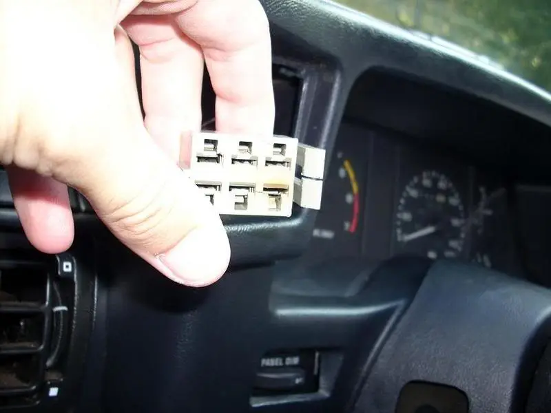

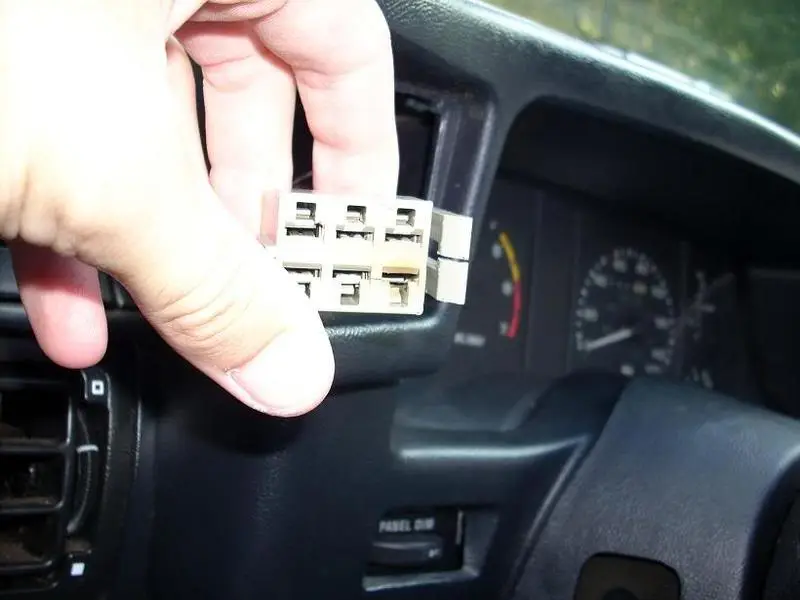

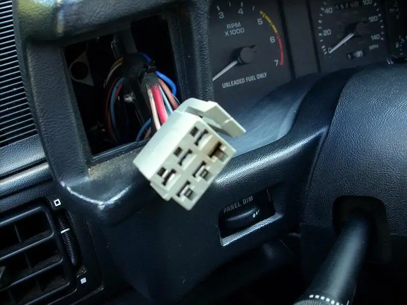

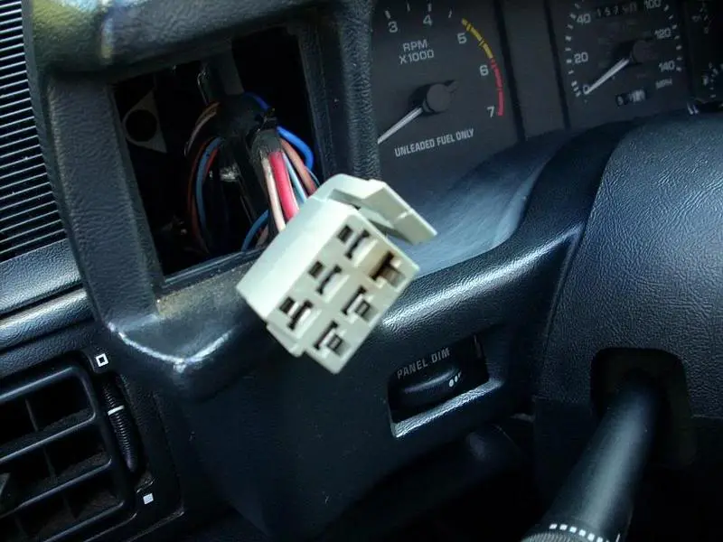

how much do i need to take apart in order to find the pigtail for the multifunction switch? i have taken the steering column boot and the 2 bigger pannels off where my knees are plenty of times and im getting sick of it. so that pigtail is what i need to lookout for? ok i just looked at the headlight switch good and its burnt. one of the corners is brown, the bridge between 2 pins is cracked and the metal piece inside has sunken down into the clip so im gonna say thats my problem. can i get those numbers for the pigtail? that way i just have to cut and splice the wires together right?

nah im pretty sure its not the switch, the switch looks fine. its the clip that goes into the switch. ill show you the pics when i get them loaded. where can i get the whole pigtail? whats my easiest option to replace this? call the ford dealership?

not too sure if you can see it but the bottom right one is kinda brown around it, and the metal connector inside is sunken down into the clip.
