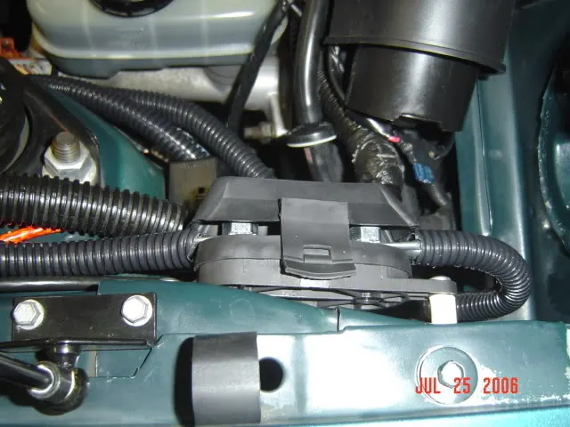

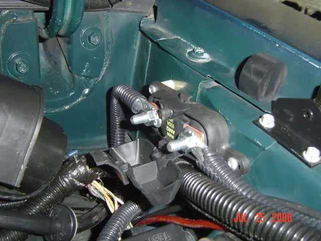

The picture shows the common ground point for the battery & alternator
Picture courtesy timewarped1972
