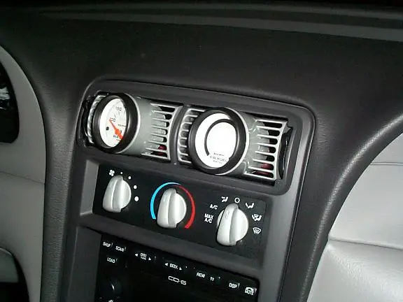

Or...you could do this....:p
It's custom. I made them. I have a dozen or so spare vents that I'd like to make additional sets out of, but I've never gotten around to it.
They're pretty cool. They're angled toward the driver, and the best thing about them is that you don't have to drill or otherwise mar your interior to install them....they pop right in and the wiring is routed behind the bezel!
