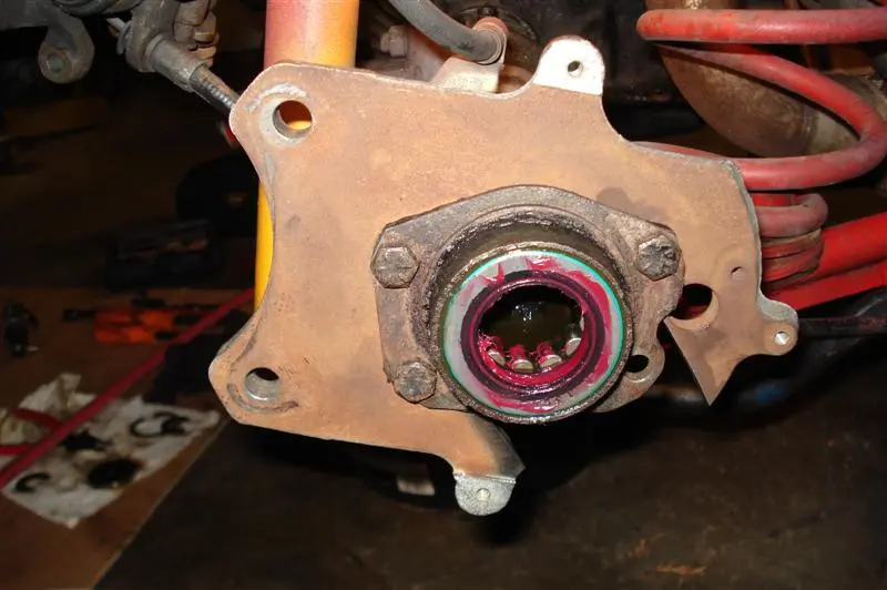

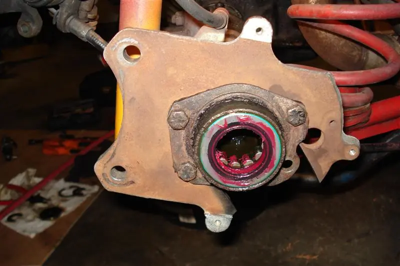

Cut the SN95 axle brackets to mount inside on the Fox housing

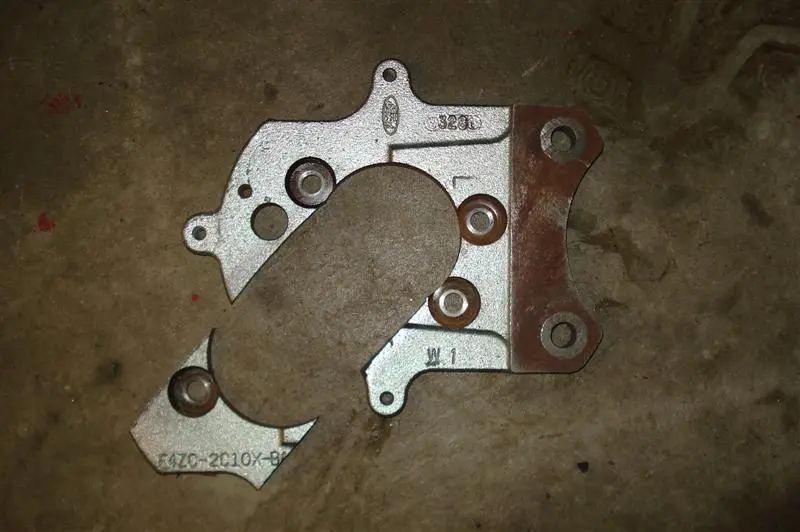

Here's how you can use stock SN95 brackets and save a lot of money. Cut how it's shown in the photos and then mount on the inboard side of the axle. The right bracket gets mounted on the left side of the car as the left bracket gets mounted to the right side of the car.

I see Saleen wheels in your sig, so you are kinda stuck using fox-lenght axles. So you have options depending on what your budget is or what you feel like doing.
#1) North race car brackets for whichever brake rotor setup you want (10.5" GT or 11.65" cobra)
#2) Midify the brackets as shown above.
