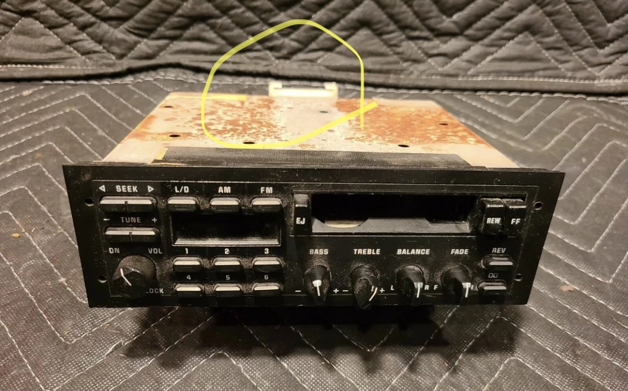

The only thing securing the radio is the side clips and the rail guide at the rear. Try pivoting the radio up and down to see if it’s caught up on the rail
talking about this piece in the back
