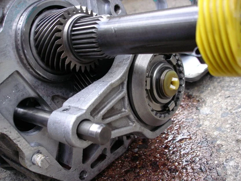

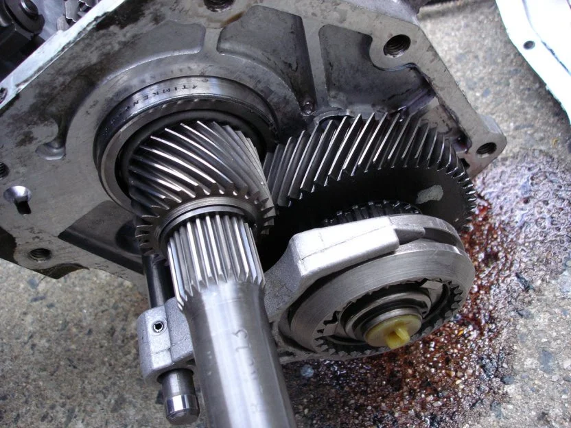

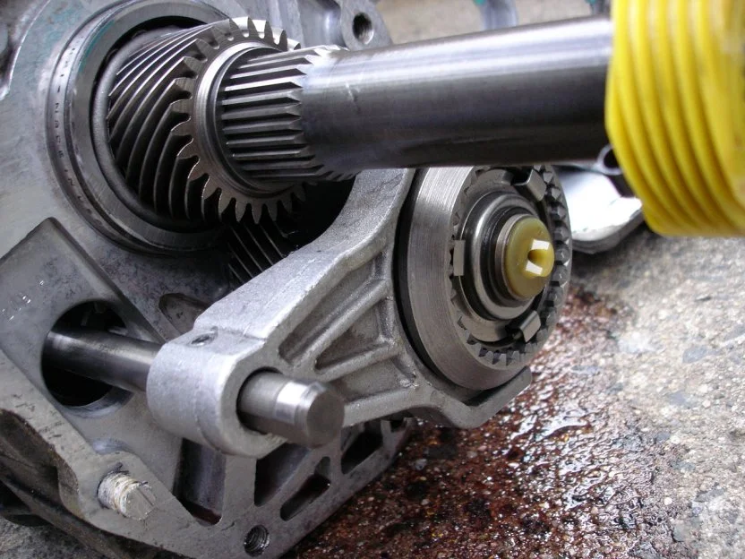

PS, this is what you'll see when you pull the tailhousing off. Nothing will fall out. It's just 5th gear. Just make sure the little orange plastic cup on the synchro doesn't fall out. Everything else here is pretty well attached, so no worries

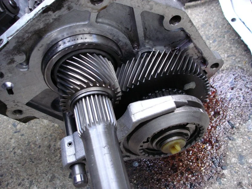

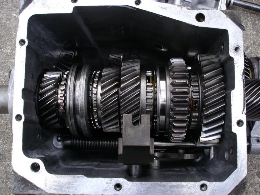

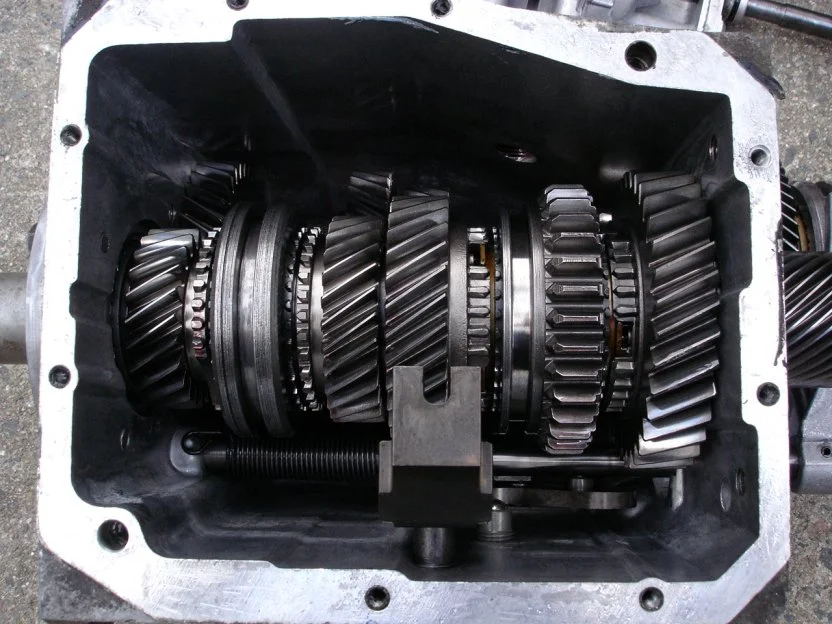

This is what you'll see when you pull the cover off. The lever in the middle is what is hanging up the cover

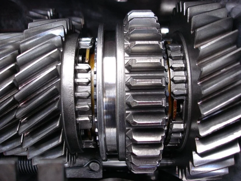

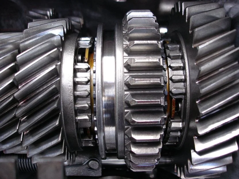

This is what you want to inspect. See all those little pointed "fingers". Those are the dog teeth and the black rings are the synchro blocker rings. You want these nice and pointed like little monopoly houses. If they are rounded over or mashed up, you'll grind up gears. The blocker rings are replaced in a rebuild but damaged dog teeth on the gears means you need to buy a new gear. Hope that helps
