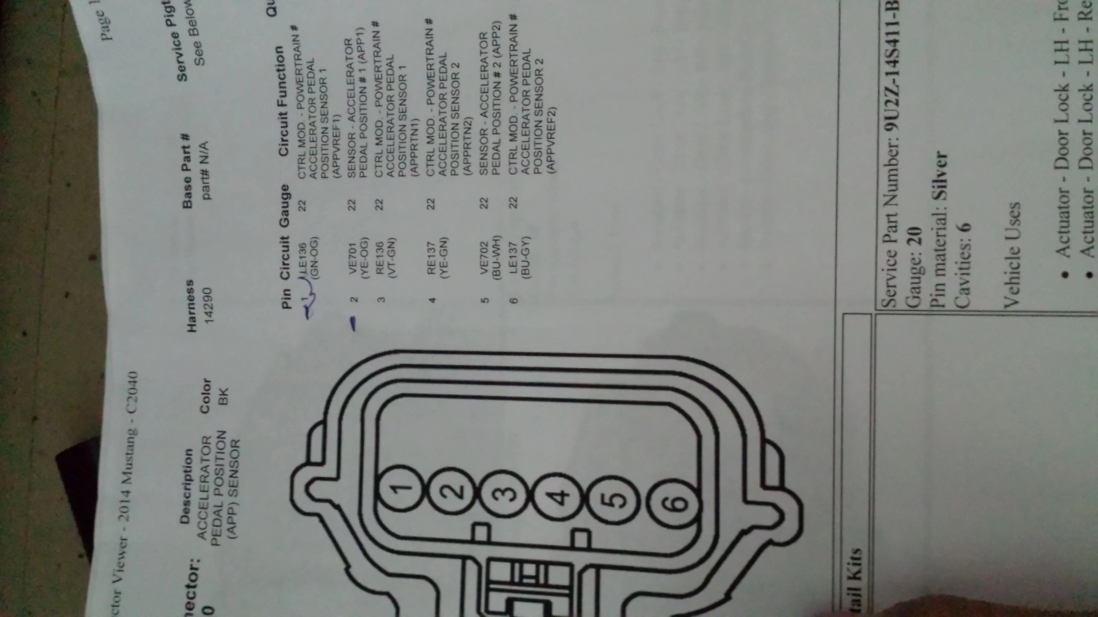

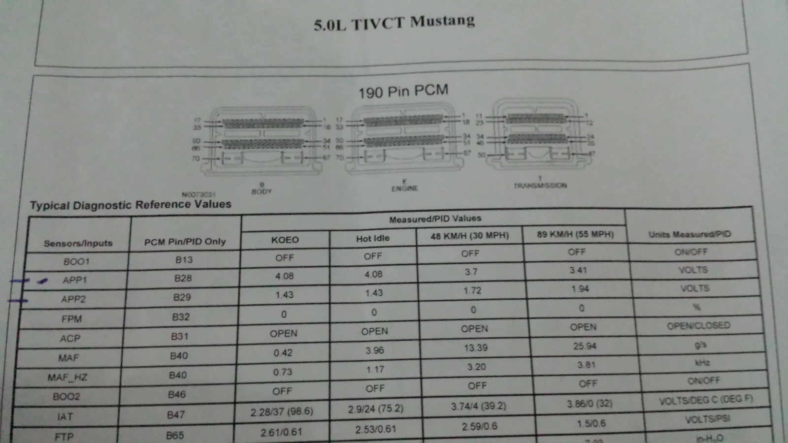

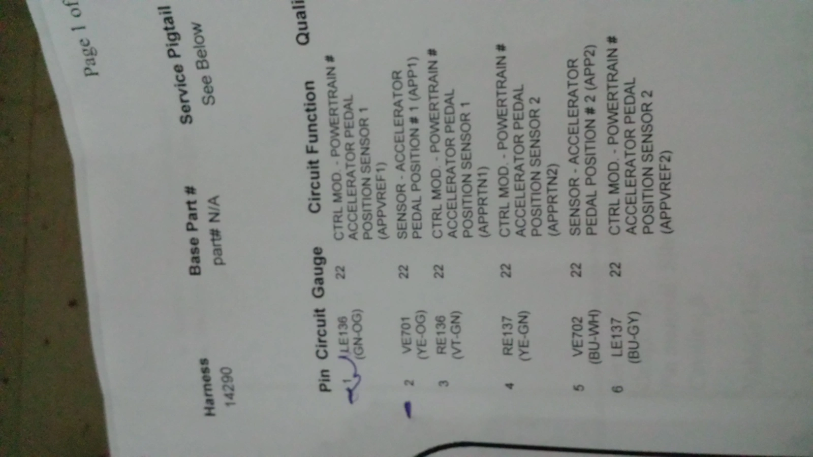

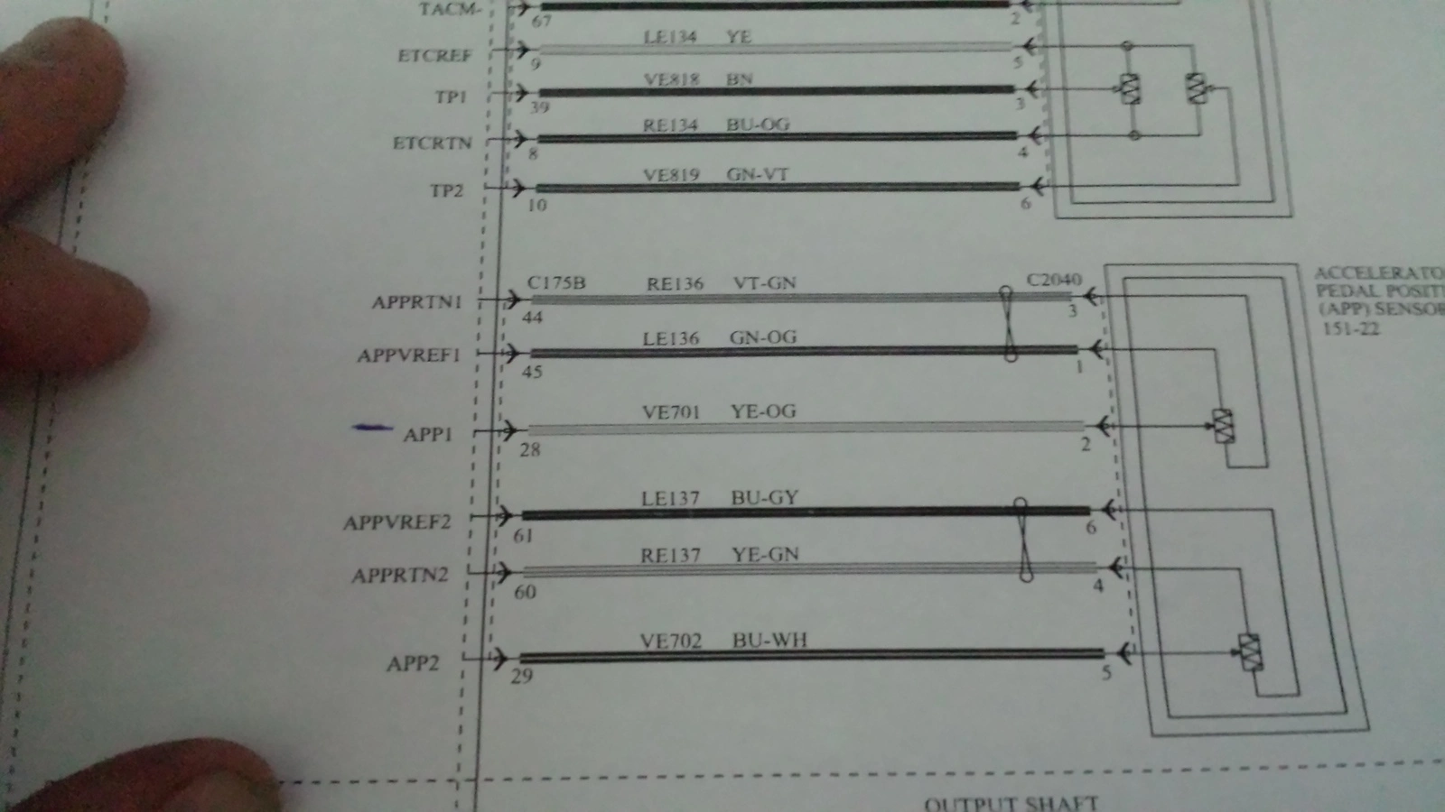

Ok Thanks. I talked to zex this morning and they said I have to find the voltage sweep wire at the pedal but he couldn't tell me which wire. So that is my mission tonight is find the wire and hook it up. Let me know if you can find anything.
If you find the wire at the pedal and you can verify the voltage is the same as the wire at the throttle body I can't see how it should make a difference but it's certainly worth a shot.
Well I got the wiring diagram from ford for the gas pedal and hooked up the nmu to the correct wire and it learned the it. It now activates at wide open throttle. Thanks for all the help. Now its time to play and see what kind of power this thing makes. Dyno time getting booked.
Reactions: Steve@CJPony
Would you mind sharing the wiring schematic that you used? This could be a resource for others that have had the same trouble that you have had
Reactions: Noobz347
It is the yellow orange wire at the gas pedal assembly.
