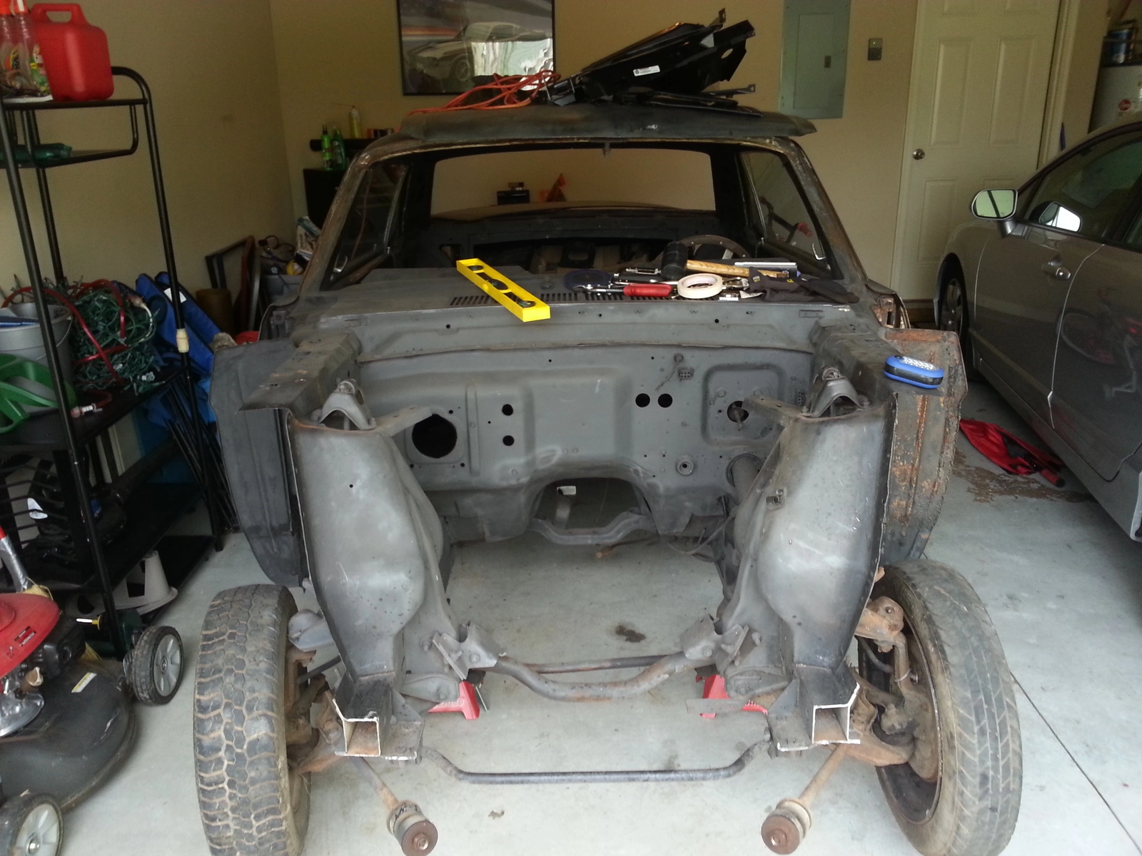

Have a 1965 Mustang and ready to restore it. Problem.... I need measurements for the frame. Starting from the shock tower to the core support. I need help. Here are some pics for a better understanding. I do not want to replace the whole frame.. just weld

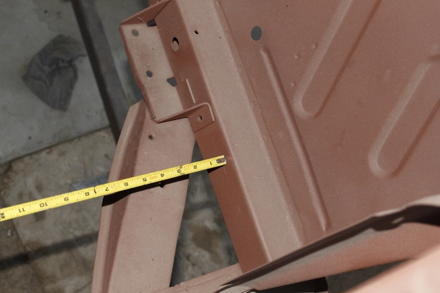

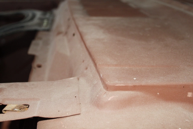

ok ,you are going to need several measurements.
lets start at the frame rails.
in between the fraim rails will be 27 5/8 inches

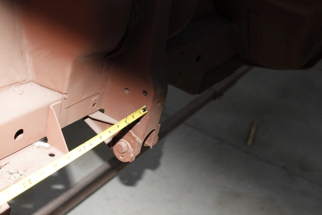

from the front of the part where the motor mount bolts on ,to the front end of the frame rail will be 23 1/8 inches

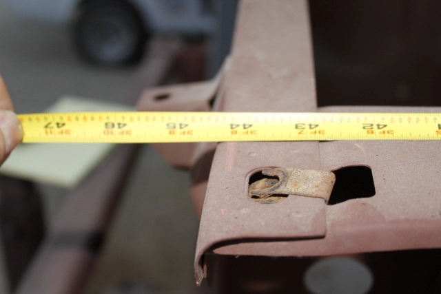

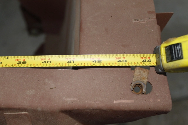

your approns will be from the top of the cowl where the hood meets up to the front of the radiator support will be 44 3/8 inches .
inbetween the approns at the radiator support will be 41 inches this is an in between the approns measurement. having trouble loading one of the pics. so it will be the last pic.were i measured from the cowl the radiator support
