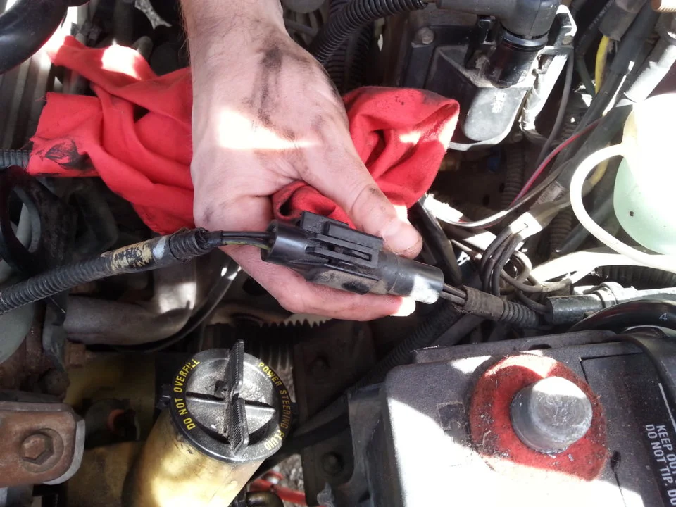

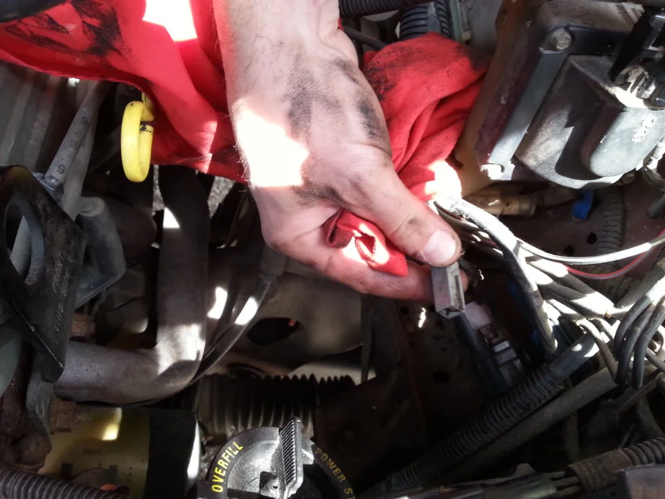

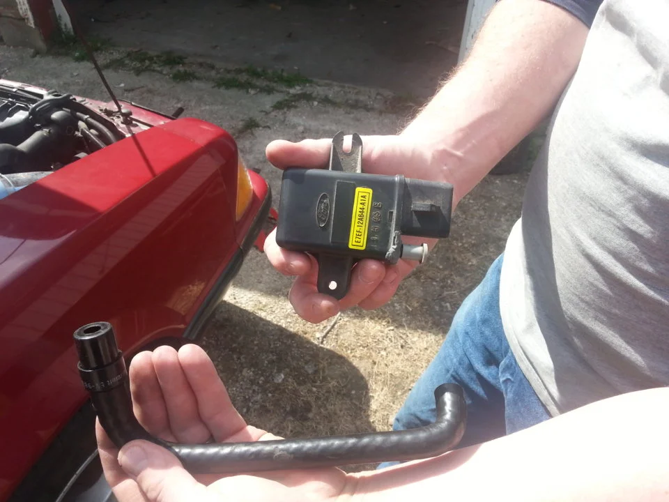

This is the probs were having with the bap. We know where it sits on the firewall but what hose goes to the bap and does it come from the upper intake? And is the hose being held in relation to the bap ?

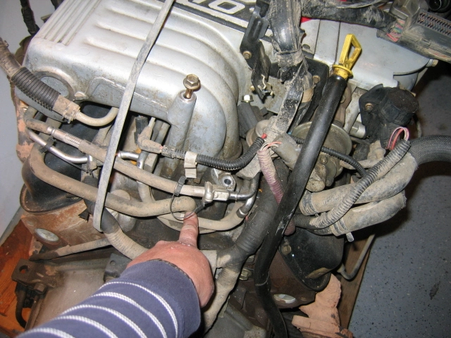

If you have SD, hook up a hose off of the vacuum tree from the upper intake to the sensor- it is then a MAP sensor, If you have MAF, plug off the tee from the manifold and let the connection on the sensor read the ambient air- it is now a BAP sensor.
The hose you are holding is the PCV hose. The PCV goes into the hole in the back of the lower intake- make sure the screen is in place- and the other end of the hose gets attached to the large connection on the driver side of the stock intake by the valve cover, or if an aftermarket intake, a large vacuum bung.

On Mass Air equipped 5.0 Mustangs, the MAP/BARO sensor does not connect to engine vacuum. It vents to the open air to measure barometric pressure.
The hose is the PCV valve that goes in a rubber grommet in the back of the lower intake manifold. The other end connects to the intake manifold vacuum. Left disconnected, it makes a huge vacuum leak...
MAP/BARO sensor operation and code 22
Revised 19-Jul-2011 to add functional descriptions for MAP and BARO operation.
On a Speed Density car, the MAP/BARO sensor is connected to the intake manifold and acts to sense the manifold pressure. Lower vacuum inside the intake manifold when combined with more throttle opening measured by the TPS means more airflow through the engine. As airflow increases, fuel flow through the injectors needs to increase to keep the air/fuel ratio where it needs to be. When manifold vacuum increases, the engine is either decelerating or idling, and it needs to reduce the fuel flow through the injectors.
On a Mass Air car, the MAP/BARO sensor vents to open air and actually senses the barometric pressure due to changes in weather and altitude. Its purpose is to set a baseline for the computer to know the barometric pressure. As barometric pressure decreases, it leans out the fuel flow to compensate for less oxygen in the air. When the barometric pressure rises, it increases to add fuel since there is more oxygen in the air. The fuel requirements decrease as altitude increases, since the atmospheric pressure decreases.
Disconnecting the MAP or BARO sensor will set code 22.
Misconnecting the BARO sensor to vacuum on a Mass Air car will cause the computer to lean out the fuel mixture.
Code 22 or 126 MAP (vacuum) or BARO signal out of range. The MAP or BARO sensor is pretty much the same sensor for both Mass Air & Speed Density cars. The main difference is where it is connected. Mass Air cars vent it to the atmosphere, while Speed Density cars connect it to the intake manifold vacuum. Its purpose is to help set a baseline for the air/fuel mixture by sensing changes in barometric pressure. The MAP or BAP sensor puts out a 5 volt square wave that changes frequency with variations in atmospheric pressure. The base is 154 HZ at 29.92" of mercury - dry sunny day at sea level, about 68-72 degrees. You need an oscilloscope or frequency meter to measure it. There a very few DVM’s with a price tag under $40 that will measure frequency, but there are some out there.

So there is no hose that attatches to the bap?Lol I'm doing my best. Thanks for understanding
Go back and read my post until it sinks in.

Your 91 Mustang is Mass Air equipped. It does not have a MAP sensor.
It does have a BARO sensor, which senses barometric pressure. It vents to open air, and does not connect to vacuum.
See my previous post on fuel pump troubleshooting. The answer is in there...

#20
  • May 1, 2015
  • #20
We found this? And...
