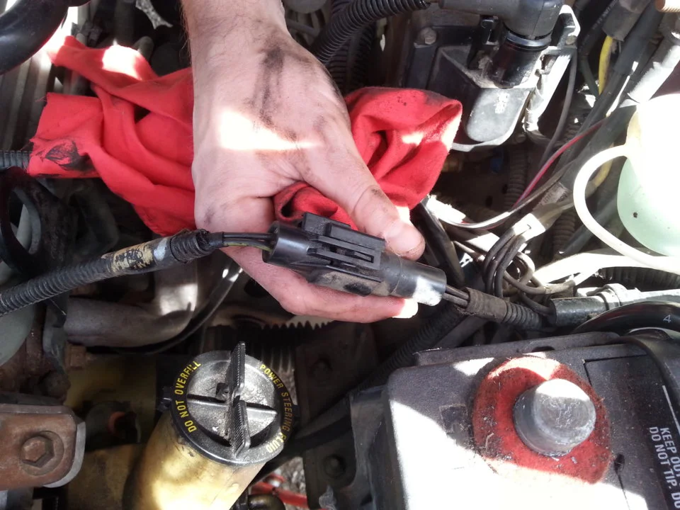

Is that the dedicated power ground off the ground pigtail on the battery ground wire? N nothing looks corroded just oily.
No.
Wrong wire colors. It looks more like The A/C compressor clutch harness.

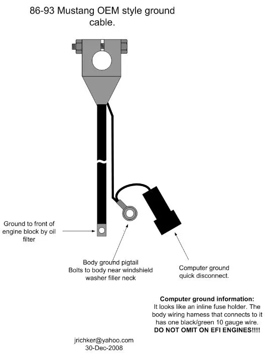

Computer Ground wire:
In 91-95 model cars it is a black cylinder about 2 1/2" long by 1" diameter with a black/white wire.
The picture shows the common ground point for the battery , computer, & extra 3G alternator ground wire as described above in paragraph 2. A screwdriver points to the bolt that is the common ground point.
The battery common ground is a 10 gauge pigtail with the computer ground attached to it.
Picture courtesy timewarped1972
Correct negative battery ground cable.
86-93-mustang-oem-style-battery-ground-cable-jpg.534322
  • 56567d1230679358-positive-negative-battery-cable-questions-86-93-mustang-oem-style-ground-cable.gif

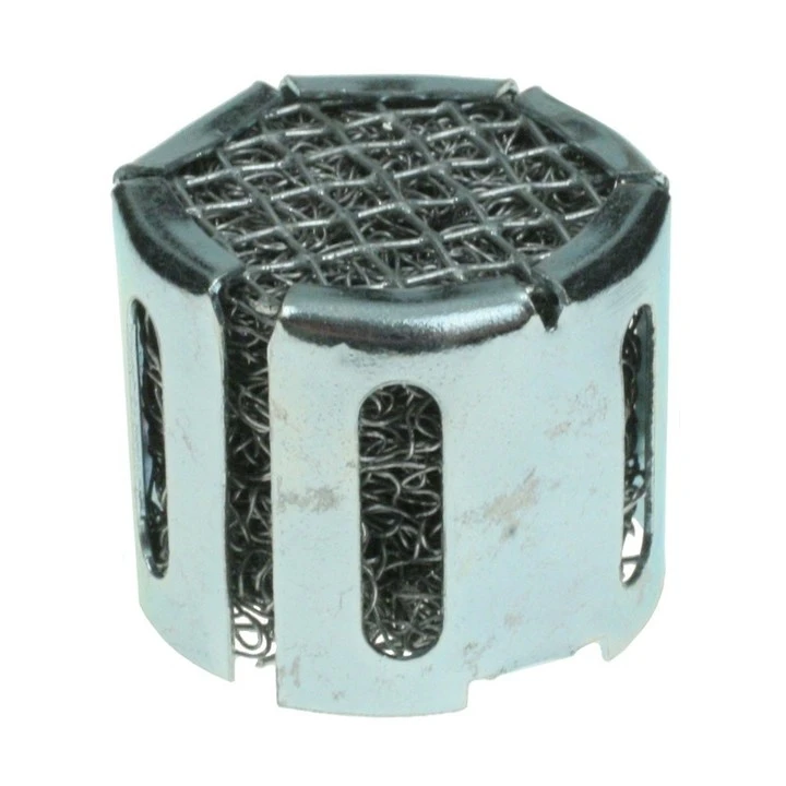

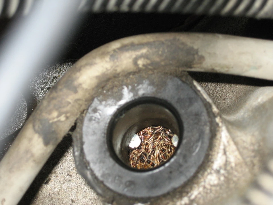

Nwould this b the screen for the pcv valve.? N now kinda don't know where to go from here cuz we checked what u said. Unless I'm missing something.
Ok phew. Got that right then. The car still doesn't purge but are getting fuel tto fuel rail. We did eeverything else that was suggested so should we pull a spark plug wire out and check for spark? With a low voltage circuit tester? Or any more suggestions. Once again Ireally appreciate all you help and time.
PCV screen
