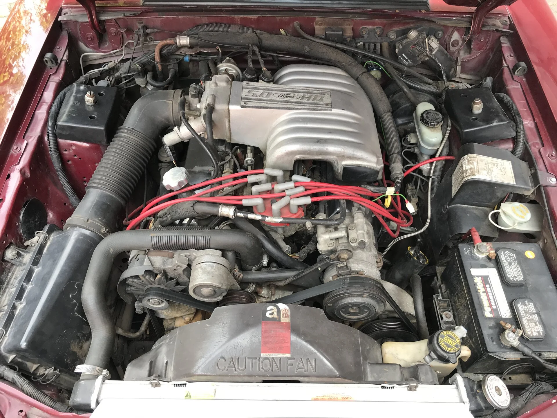

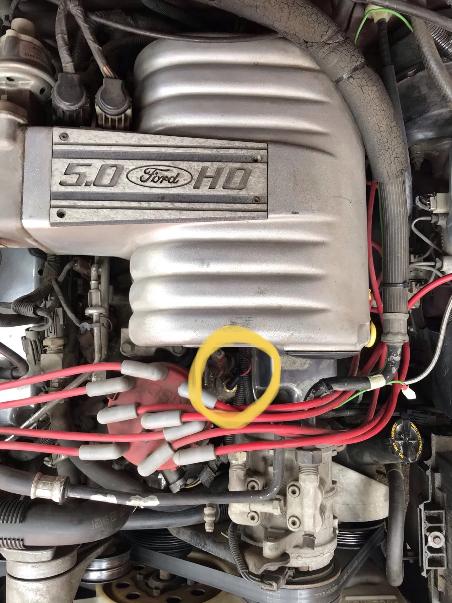

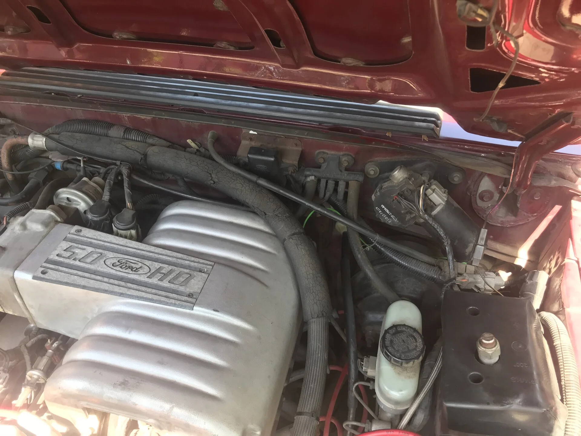

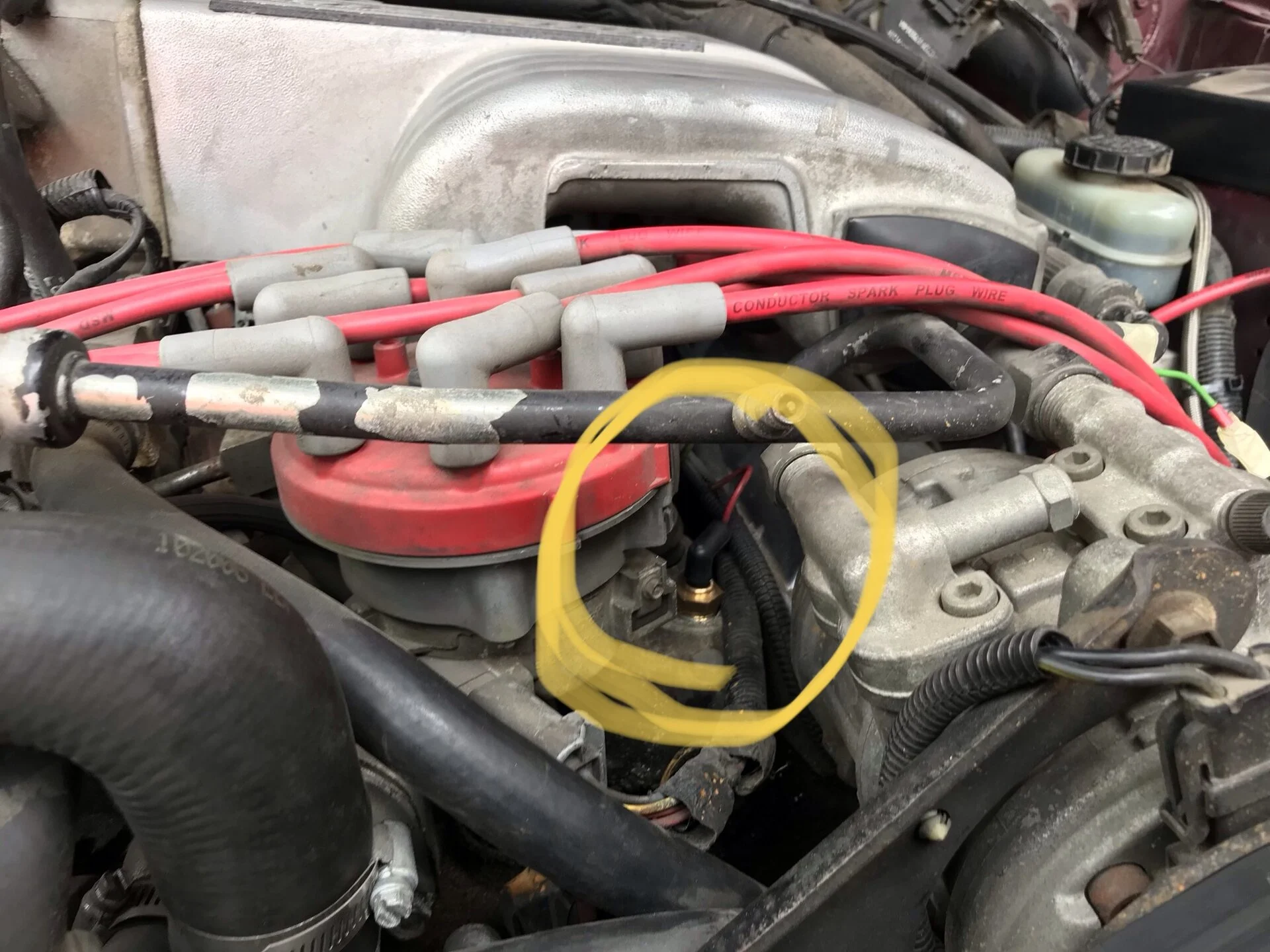

Show us a pick of the top of the engine and point to what you are calling the 'temp sensor' , I suspect you are looking at the temp sender,
How long have you owned the car?
Have you checked fuel pressure?
Here are two pics of what i call temperature sensor.
