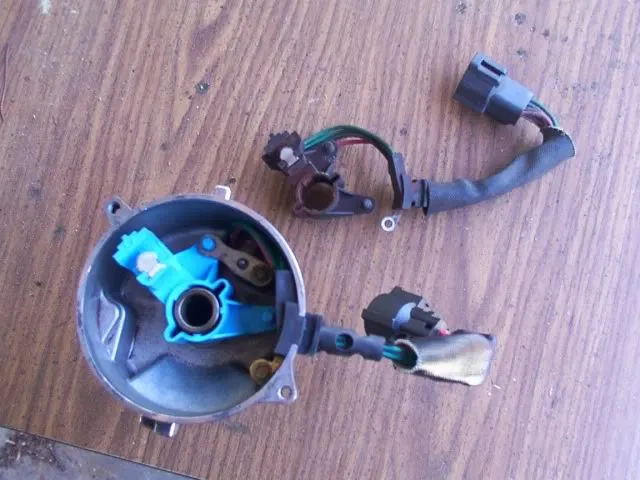

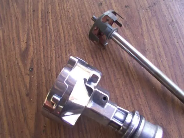

I just got through changing the PIP sensor and everything seems to be running smooth! I let it idle for a long time, took it for a few drives, idle some more. Turned it off and started it a few times in between, started up everytime with no issues.
Of course you can't do anything on these cars without something else messing up, after starting it back up I notice water gushing out from my water pump area. Thought it was the weep hole, but turns out it's just a gasket. Have to replace it tomarrow.
While I had the dizzy apart I decided to do a quick polish on the housing and resurface the bearing surfaces. You could hear the shaft grinding as you turned it (sick minds stop now!!) So I used emery cloth to smooth out the surface of the shaft and then polished it to a shine. Now the shaft spins like butter.
Here's a couple pics for ya's:
