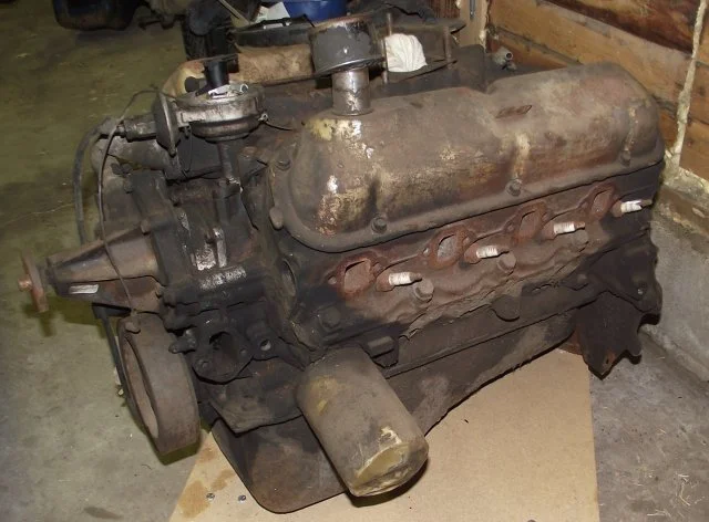

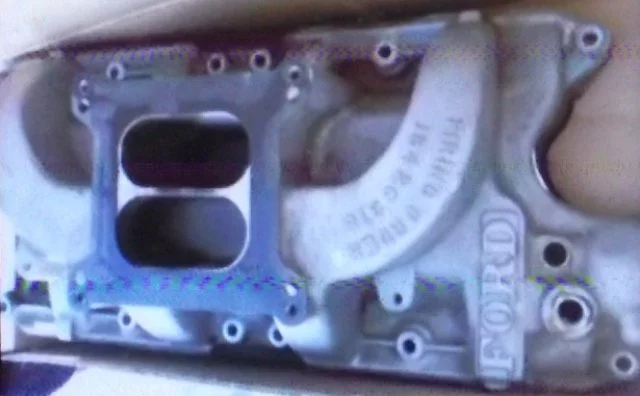

I bought a new project pony, a 1965 coupe C code, that someone has put a 6 cylinder in when it was originally a 289 v2. So I put an add in Craig's List looking for a 289 and I get a cal from a 70 year old guy who says he has several and one is a 66 HiPo. I was more interested in a 1964 289 with only 65,000 miles but thought what the heck I'll bargain on both. He also told me the HiPo now had a 2 barrel manifold he put on years ago for better gas mileage, and that it used to have a dual point distributor but he took it out and put it on a falcon. He says he has the manifold and it's an aluminum 4 barrel that says FORD on it.

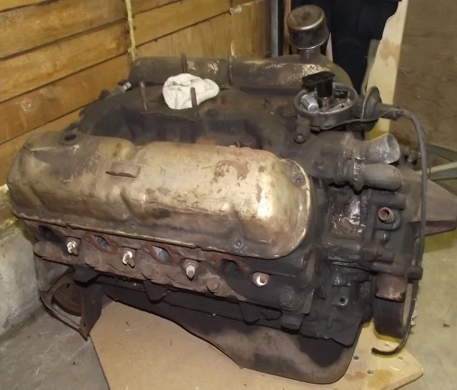

Well I ended up giving him $500 for 3 motors, yup he had another clean looking one I couldn't pass up, and the manifold. My nephew went down and got them for me. I got them back last night and looking over the "HiPo" it sure looks to be the real thing from what I know and can see. Here is some pictures. What do you think?

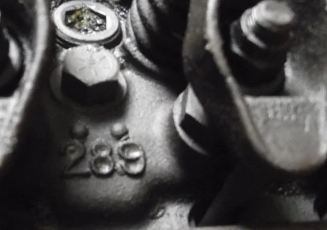

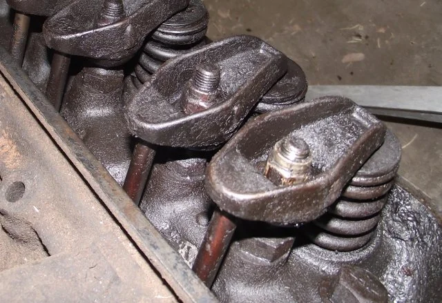

Has the 289 cast with two dots not one and you can see it is screw in studs.

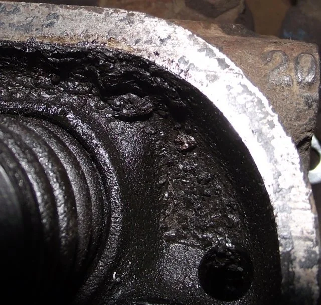

Has the cast number 20 in the corner of the head and you can see the spring pockets.

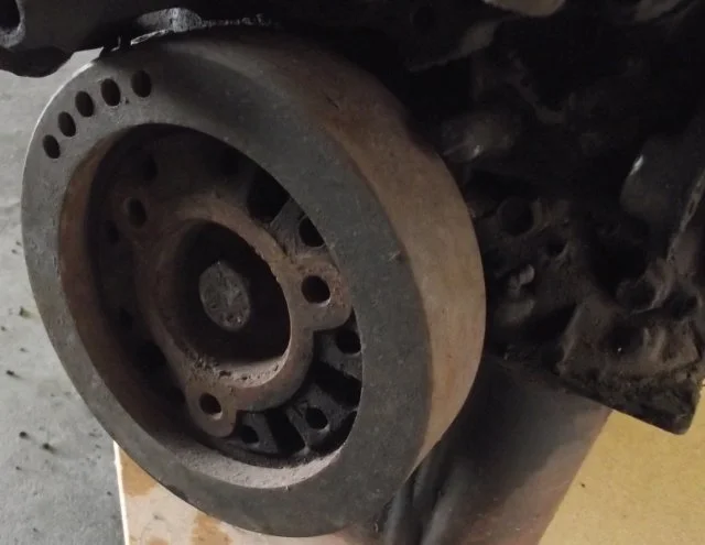

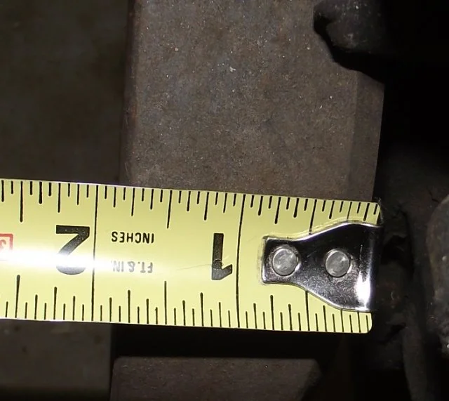

It has the thick harmonic balancer that measures 1.75"
The intake.

It actually does look like a HIPO. It has the valve spring seats, screw in studs and balancer.
This is the first "HiPo" Ive seen that actually appears to be a HiPO.

I agree. The intake, of course, is not original. But it's obviously and over-the-counter Ford version of the Cobra intake, a nice upgrade.

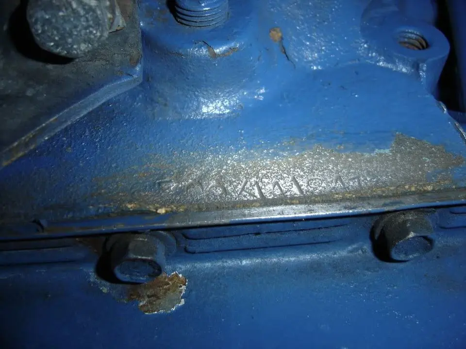

while you are at it, look for any vin numbers on the block. if its a real hipo, someone may pay a lot of dollars to buy it.

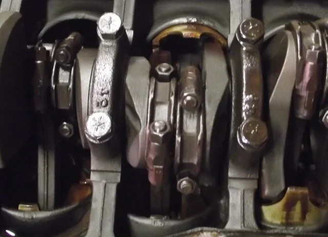

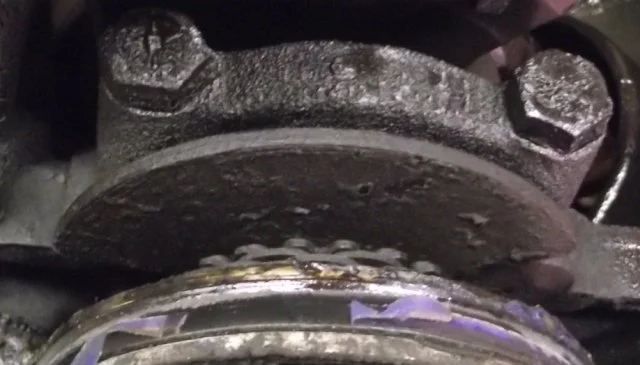

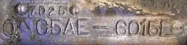

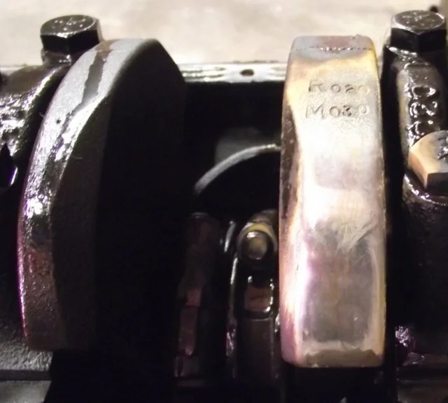

I pulled the pan last night and I'm still confused. It has the crank weightbob, it has the polished point on the most aft counterweight used to check nodular levels met specs, it has the 3/8" rod bolts, but the caps don't look right.
Block numbers.
Weightbob.
polished aft counterweight.
Caps.

Not HiPo caps. I wonder if someone either threw a rod through the HiPo block and used what was left, or was building a HiPo themselves with a regular 289.

The only thing odd here is the caps. Everything else is proper HP.

Pretty much I wonder if it has the correct camshaft.
