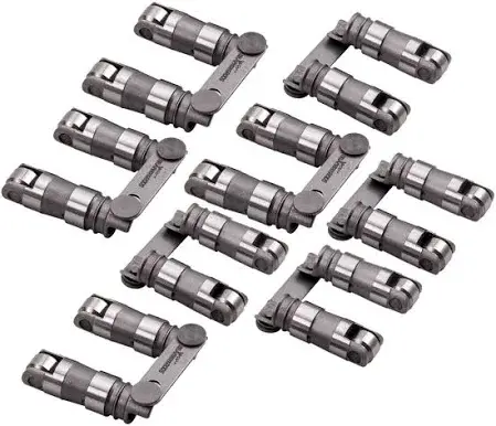

If you're getting the block machined for a rebuild or stroker then it's cheap and easy to have them drill and tap for this:
LMR, Amazon, Summit, ETC....
Or you can go with something like this:
That doesn't require additional machine work.
