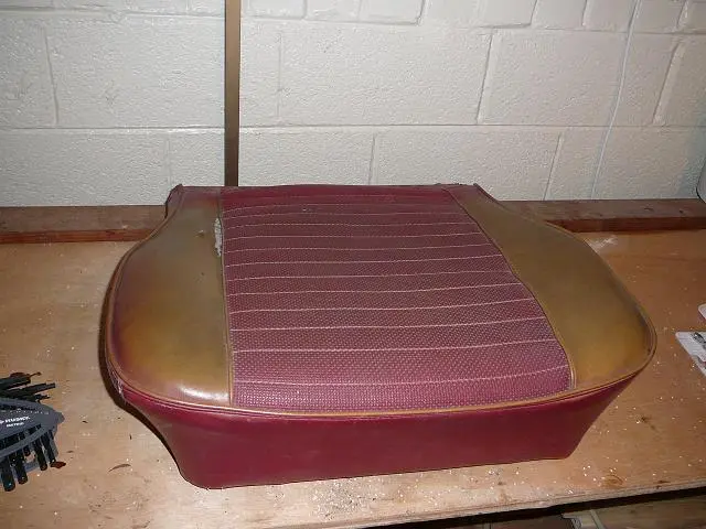

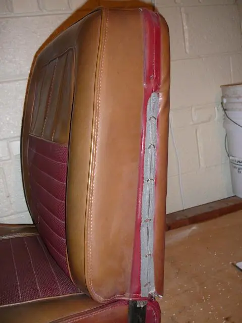

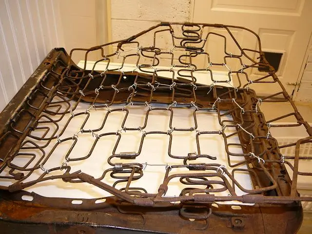

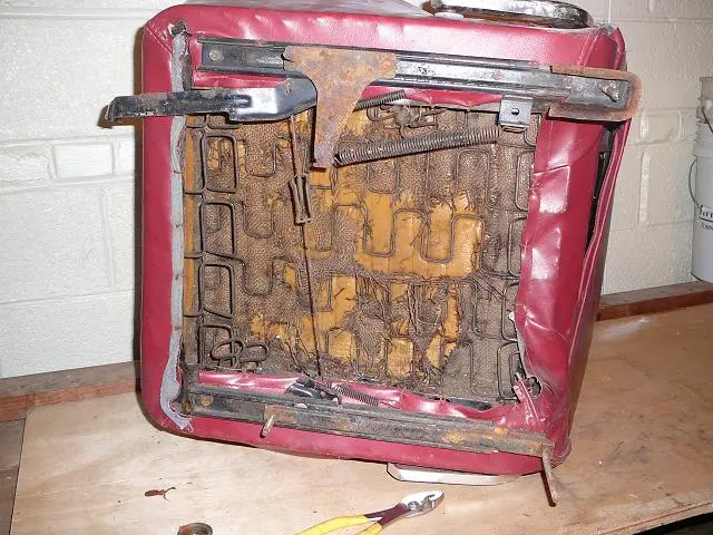

Or rather hog ring hell! I am starting to work on replacing the seat covers ...
man, there must have been 50 hog rings in just that one seat!

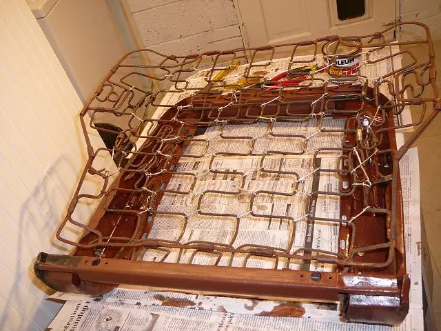

i am planning on painting it with some rustoleum rusty metal primer, that should protect it.
and i was thinking about replacing the burlap with canvas and taking some wire and reinforcing the structure a little. the original burlap had some wire sort of weaved into it to reinforce the skeleton
i think i should attach the inserts in the creases first, then the wires to the frame, and then around the edge. that seemed like the most straightforward to get the old ones off. :shrug:
i don't know how i'm going to get the new ones on there nice and snug ... i've never done this before. any advice?
should i do do a couple rings on one side, then a couple on the other, and keep alternating, or do all of one side before going to the other side?

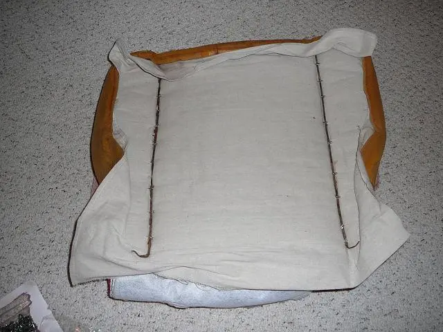

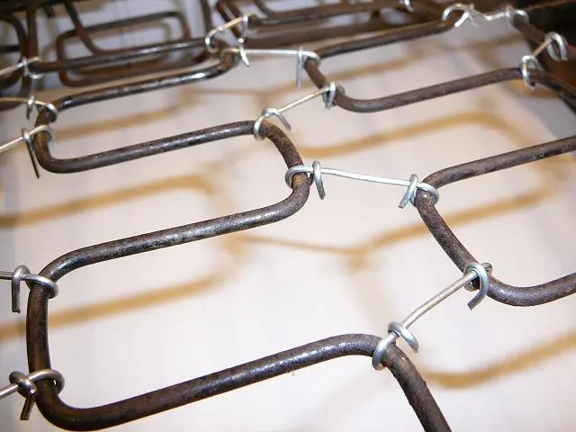

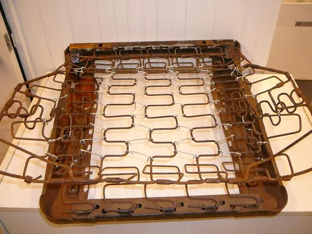

As to other updates, I got a 200 foot roll of 16GA wire ($7 at Home Depot) and started reinforcing the skeleton. I have some Rustoleum Rusty Metal Primer to paint it with. And I am going to an upholstery shop over lunch ... Custom Canvas and Upholstery.
you might want to test sit in it? You may find it too stiff and find the need to remove every other or every 2nd link you made with the 16ga wire.
Looks like you went hog wild with the 16ga...I am sure it helped but you dont want to overdo it in a car that is full framed and has a 40-50+yr old suspension design.
i think you are right, i did go hog wild with the wire :) i was thinking that the 40+ year old springs could use some help, but i may have made it too stiff now.
i have not test sat on it, that is a very good idea

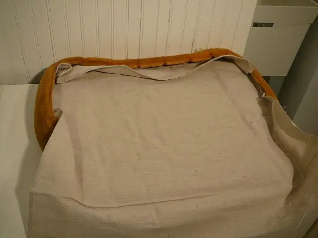

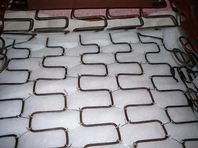

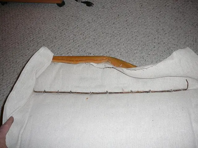

i got a canvas drop cloth at home depot to replace the burlap. i think i will glue that to the underside of the foam because that is ready to fall apart and could use some help with its structural integrity.

I was thinking about it some more, and I think it will be OK because the burlap looking stuff had wires weaved into it that essentially served the same purpose. I am definately going to do a sitting test though too.
painted with rustoleum rusty metal primer

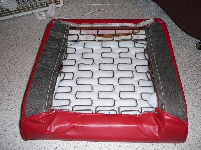

with the canvas glued to the bottom of the pad
attaching the pad to the cover
the pad is in!

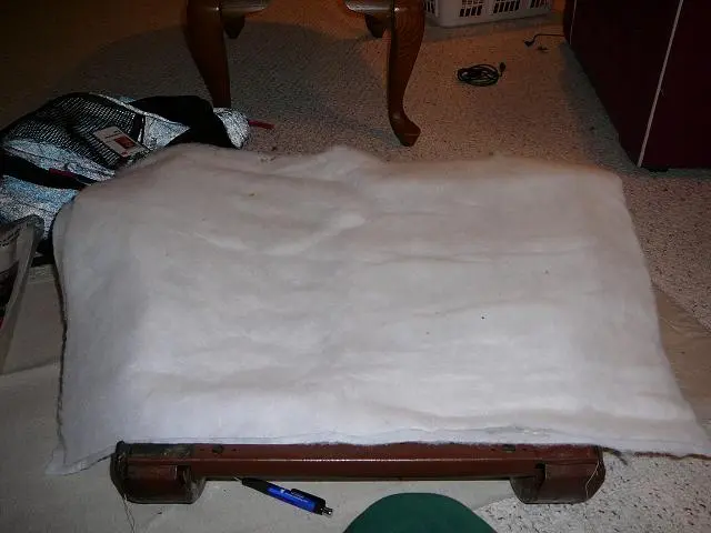

the batting on the frame

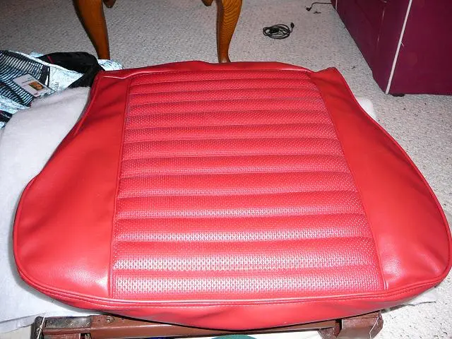

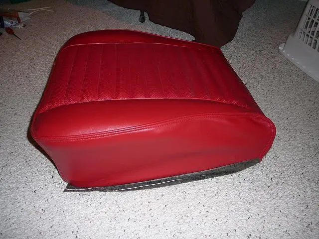

this part was a bitch, but i finally got it on!
without the hog rings attached to the bottom

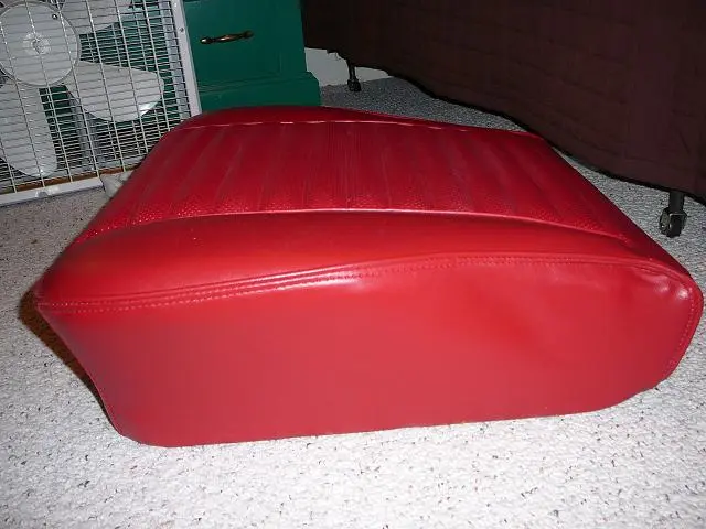

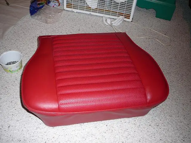

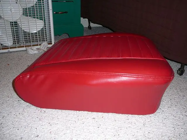

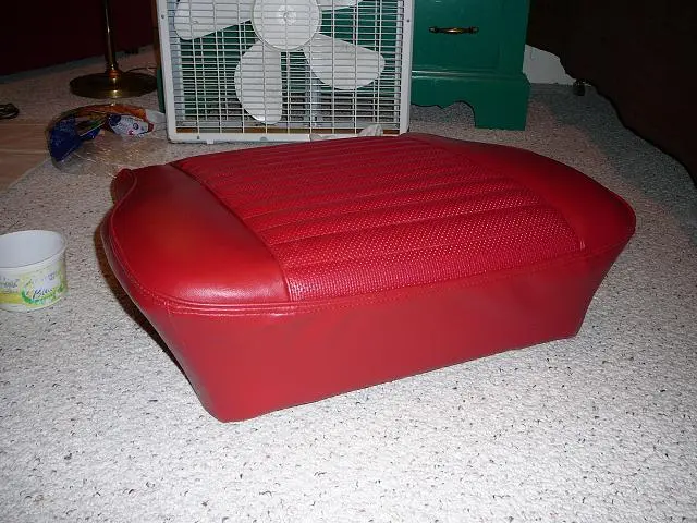

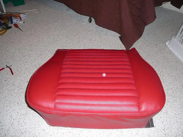

all done!
from below
