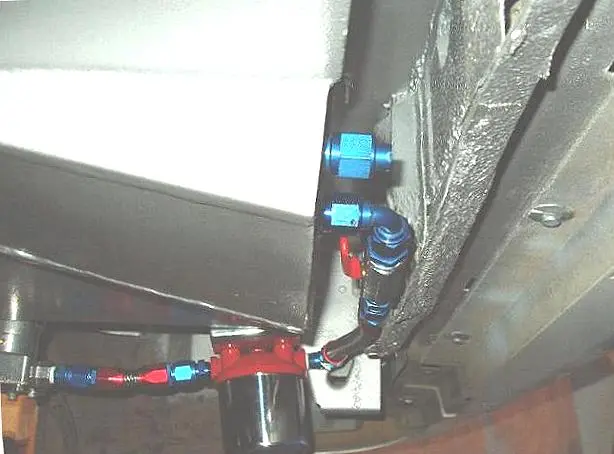

MOST electric fuel pumps are designed to have the fuel gravety feed to the inlet, and push the fuel. They are not designed to pull the fuel from a lower point. They can pull some, but it is best to install them so the pump inlet is at, or below it fuel level in the tank.
Below is the fuel line coming out of my fuel cell, into the filter, then to the fuel pump. A sumped tank will give the same end results.
