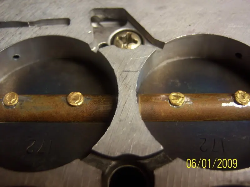

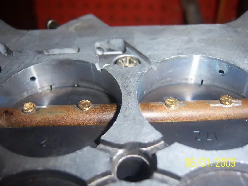

56k beware:
Took the carb off and reset the primary throttle blades from:
To this (.020 on the transition slot):
put it on and took some fiddling to get it to idle correctly. Set the idle to 850 and took it for a drive, it still was surging and shuttering above 2200. I stuck wire in the LSABs on the primary and took it for a drive. My A/F was restored! But it still surged even with decent (12:1) A/F. So, on a hunch, I thought I may have had too much timing in it so I pulled the vacuum line to the vac advance, removed the wire from the LSAB, and drove it. It did not surge! vacuum at cruise jumped from 16 to 20. It was rich at cruise, but a def. step in the right direction.
My next step is to change the light springs in the dizzy for heavier ones and get my advance in later, then mess with my cruise AFR, which is set by idle mixture screws right?

The idle mixture screws are just that, idle mixture screws. You had too much timing, therefore the reason you couldn't get it to idle down where it needed to be. So did you have the primary blades open too far or closed all the way. In the beginning of this thread, it sounded to me like you had the primarys open too far, exposing too much of the transfer slots, thus the reason the idle mixture screws didn't respond. In my opinion, it's still idled too high at 850. It should idle fine at 500-600.
