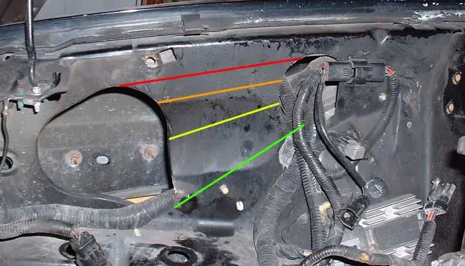

for the fender.... a metal sawsall blade. cut form the big hole to the small hole... then roll the meltal up and down accordingly. you can use a sheet of metal to cover this hoel , leave it open, or use a mud flap like he did.
mudflap will be easiest to cut
Any more info on this hole that needs cut? Check out this pic of the fenderwell that needs cut. I've put 4 different colored lines on there that are possible cut locations. Which one is preferred? Maybe 2 cuts, like orange and green and then roll orange?
Rick
