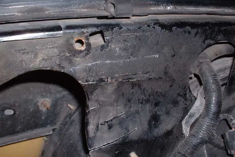

Thought it would be better to dig this up and just add to this near FAQ rather than start another thread...

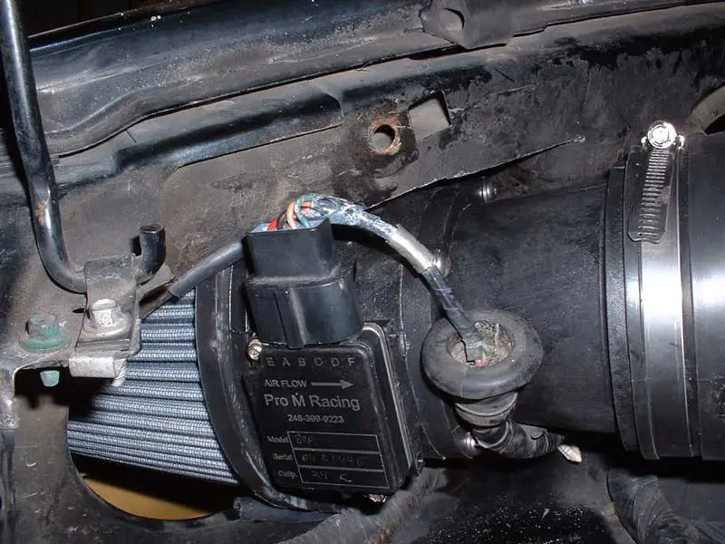

Here's a couple pics of what I did. One is the actual cuts I made with a jigsaw and the other is what the full length Pro-M 80 looks like installed.
Rick

Here are a couple of pics of prototype #1 where I incorrectly located my IAT relative to the crankcase vent (aka PCV inlet). The oil splatter is directly across from the crankcase vent nearly hitting the IAT. I suggest moving the IAT as close to the MAF as possible to prevent it from getting contaminated with oil. Prototype #2 now incorporates that modification.
Rick
