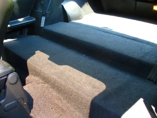

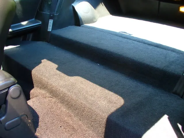

I just got a big cardboard box and cut a rough shape out of it for the vertical part, test fit/trim/test fit/ trim/etc. until it was right. Parked the car on a level surface and used a level with one end on the flat area in the back and got a height for the front piece. Traced it on 1/2" plywood and cut it out. Did the same thing for the flat piece and put speaker carpet on the whole thing. I did a piece all the way in the back and it turned out pretty nice. Just takes some time but worth it if you ask me.

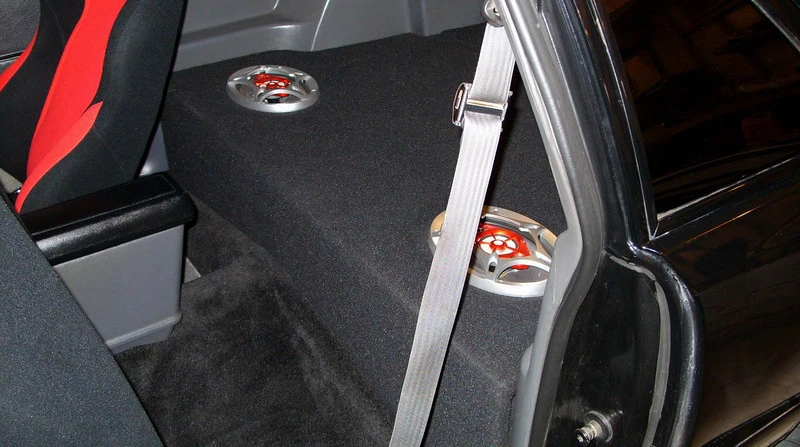

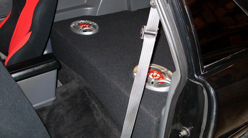

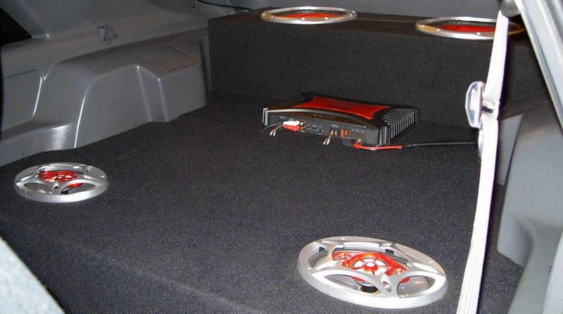

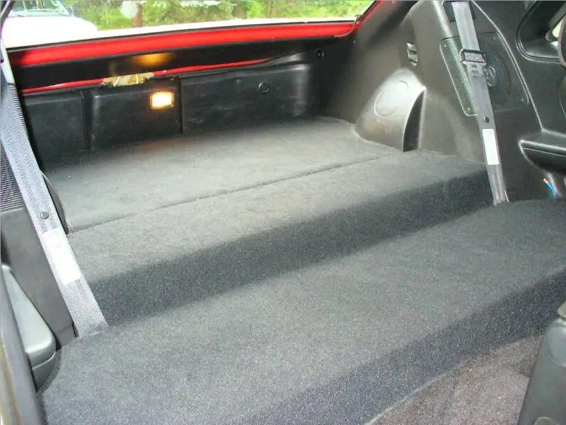

I prefer a look that follows the contours of interior panels. It's more measuring, cutting and shaping but I like how mine came out. Too bad I don't have the car anymore.

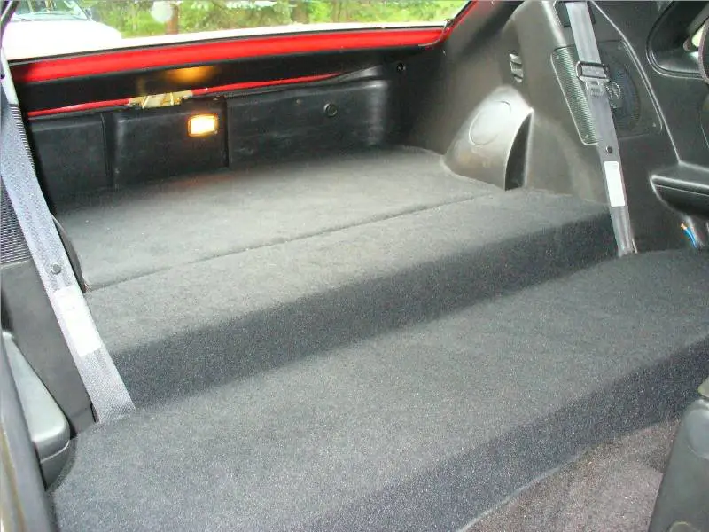

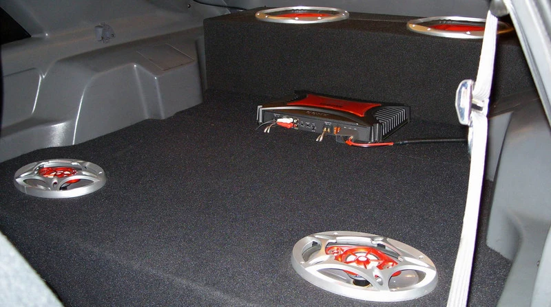

I also made a vertical cargo area divider panel that sits in the flat notch of the shock tower covers, but never put it in. I thought that would "finish" the overall look better - hiding the fact that there is something missing - namely the rear seat.
