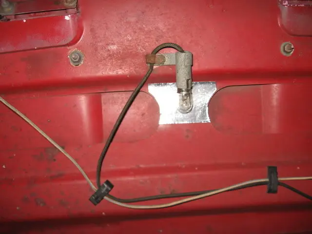

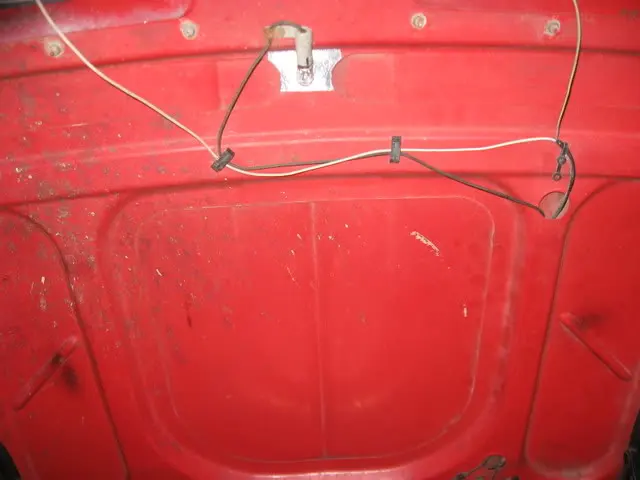

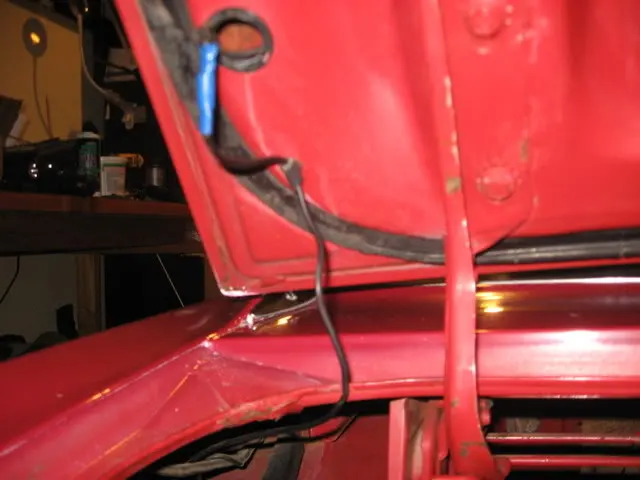

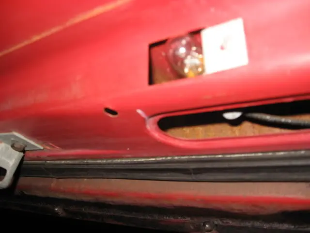

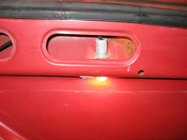

tx, if it helps you any here's a few pics of my factory optioned hood and trunk lights in my '67 Coupe:
I put the reflective tape over the hood light to reflect more light down, illuminates the engine well at night cruise ins and actually shines in front of the car too, really stands out at night.
You'll need an inline fuse at the solenoid, can't remember the size but I think it's small, like 2A.
Jon
