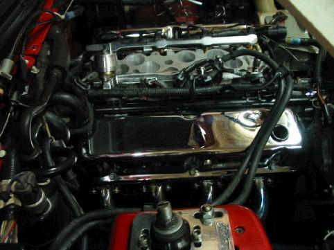

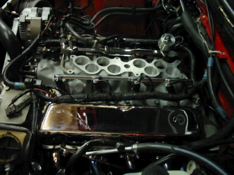

I just did an Explorer....i have Chrome VCs, they're like 3 3/4" tall...it did clear them without a spacer...BUT...I did have to "massage" the VCs here and there....The TPS was just touching by the oil fill....the EGR was the same, i had the Mac adapter....and the nipple on the drivers side that feeds the PCV hit a touch...you can see some "dimpling" in the pic.. :mad:
I still have the hood blanket in place too...
Some of this may apply for what its worth....I'm swapping to a Fox TB set-up to clean things up on the pass side...
couple more "dimples"...I may very well swap these out over the Winter...
Drivers....dimple for the nipple out back...'
Pass.......by the oil fill hole...plastic on bottom TPS was problem....Like I said..This was using the Mac adapter...and Eddy/FMS/TF adapter may not do the same???

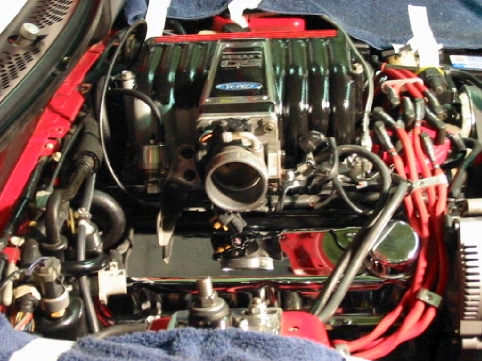

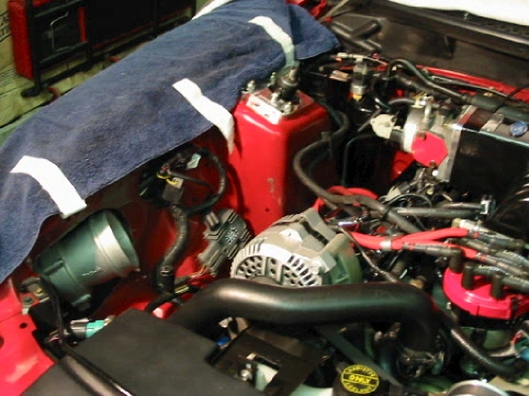

Tom....So you tore it down... :banana:
I have to scab in the TPS wires and figure the CAI...Kinda at a standstill with the CAI...Its a long run to the MAF in the fender??? Don't want some crazy looking set-up???
