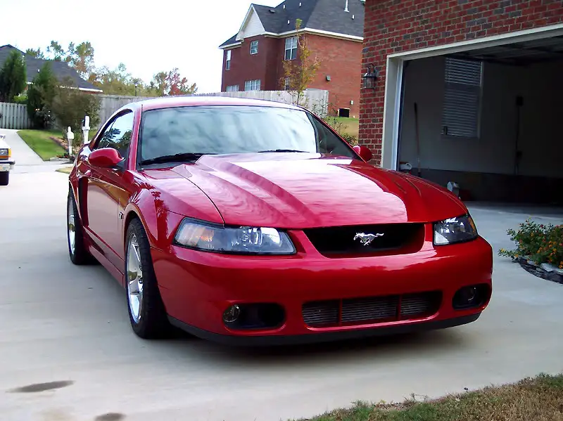

Honestly, unless you're running a race car that sits higher in front than in back, I think your best bet is to look for a small cowl hood, such as the '95 Cobra R hood or the '00 R hood. IMO, the '95 R hood looks great on all SN-95s (both aeros and new edges).
