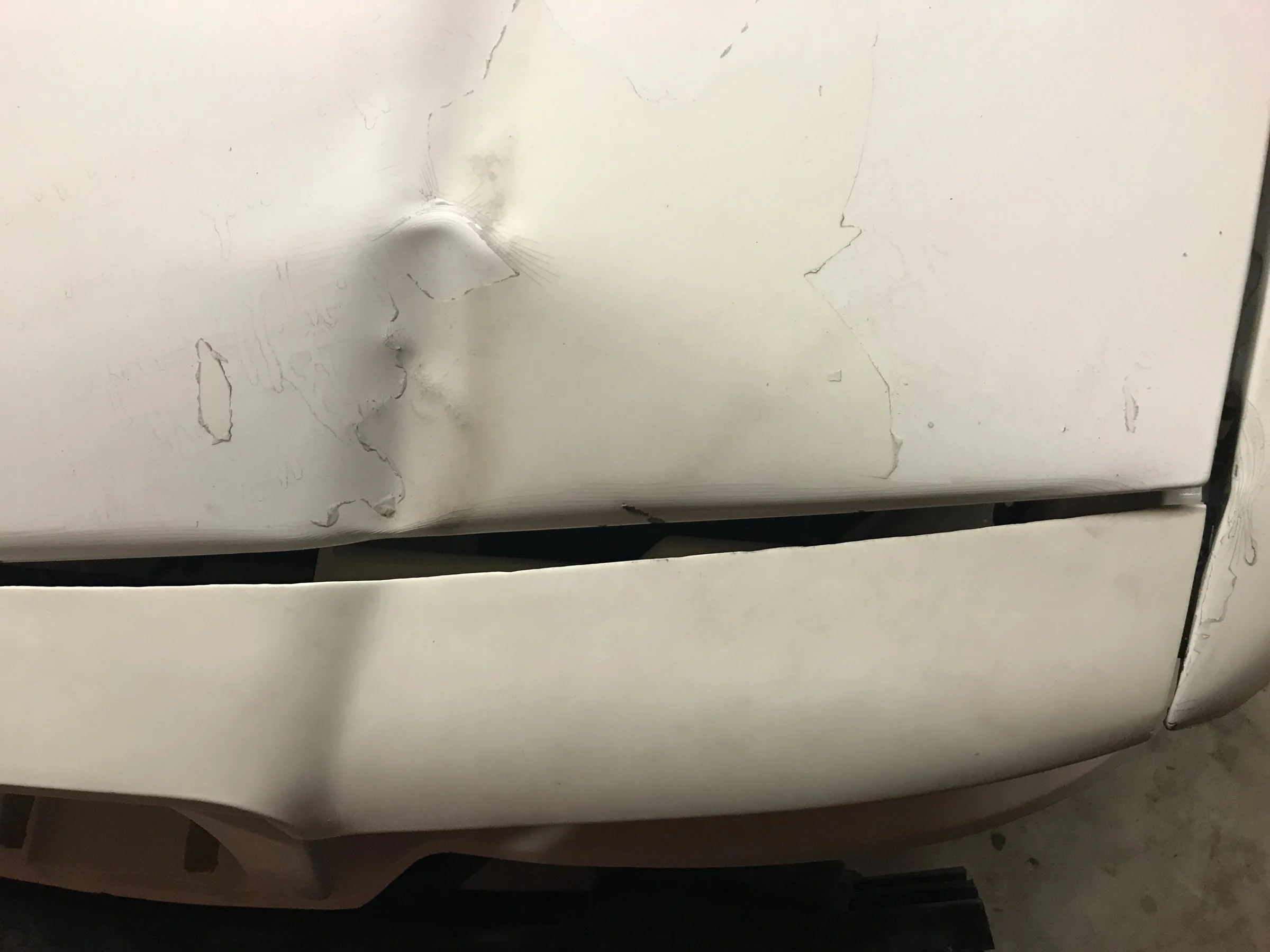

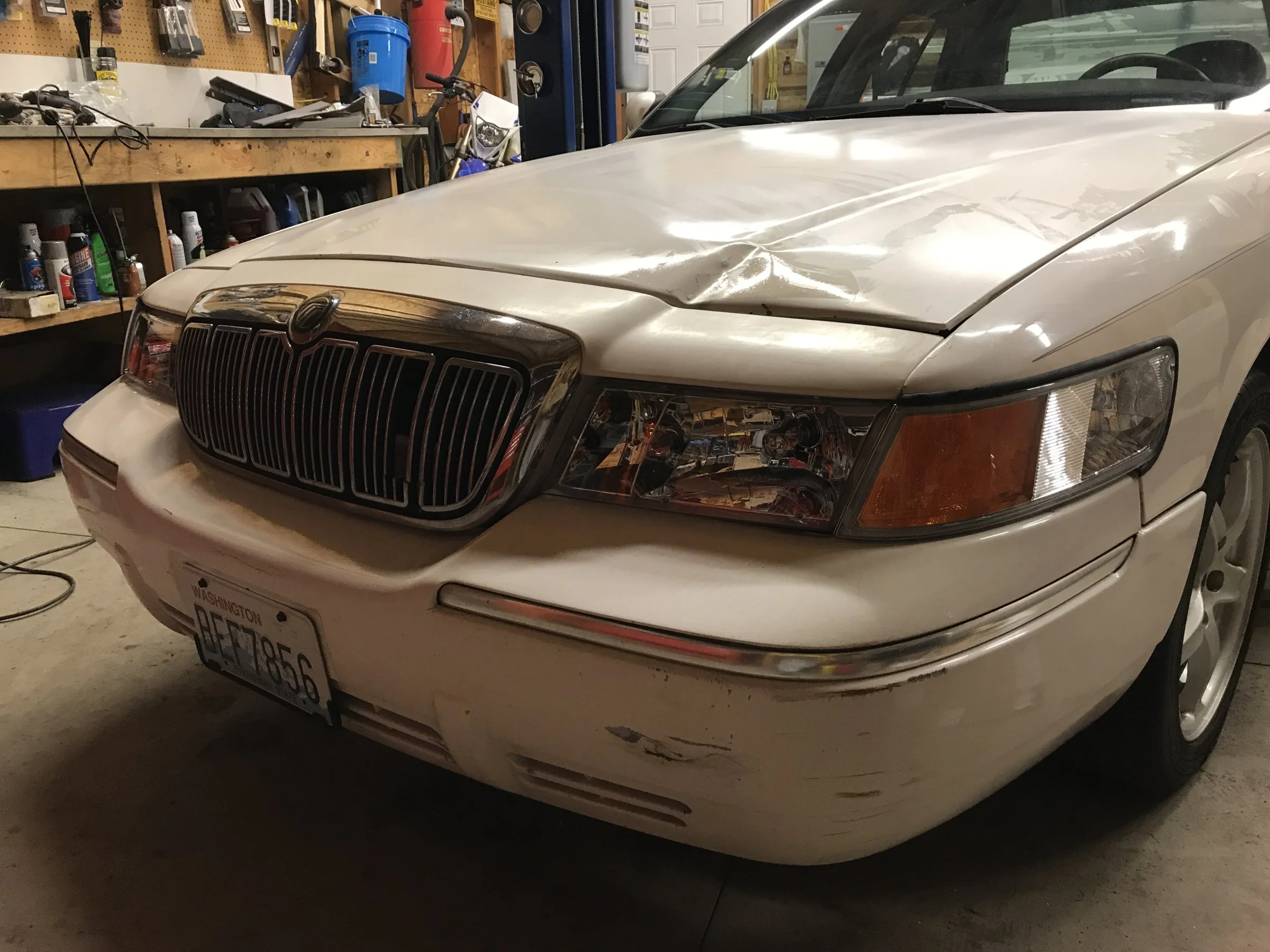

SoI got a decent 99 Grand Marquis from a co worker for $500 it is a little rough but I am beginning to really dig the car. I just replaced the header panel headlights,corner lights and the grille is still on the way. I think it looks pretty decent but the hood has some damage and I hope to get some ideas/tips on how to make it look better. I am not looking to make it perfect just better.
I know we have some guys versed in bodywork so what do you say?

go to you tube and watch some of the paintless repairs guys and pay attention to some of the pry bars they use. some of these can be fashioned out of scrap metal, small pipe or even rebar. It's not as hard as it looks, push the bents out as best you can and then fill it with bondo.
no, heavy ass steel.
That's good actually. Do you have access to a nail gun?

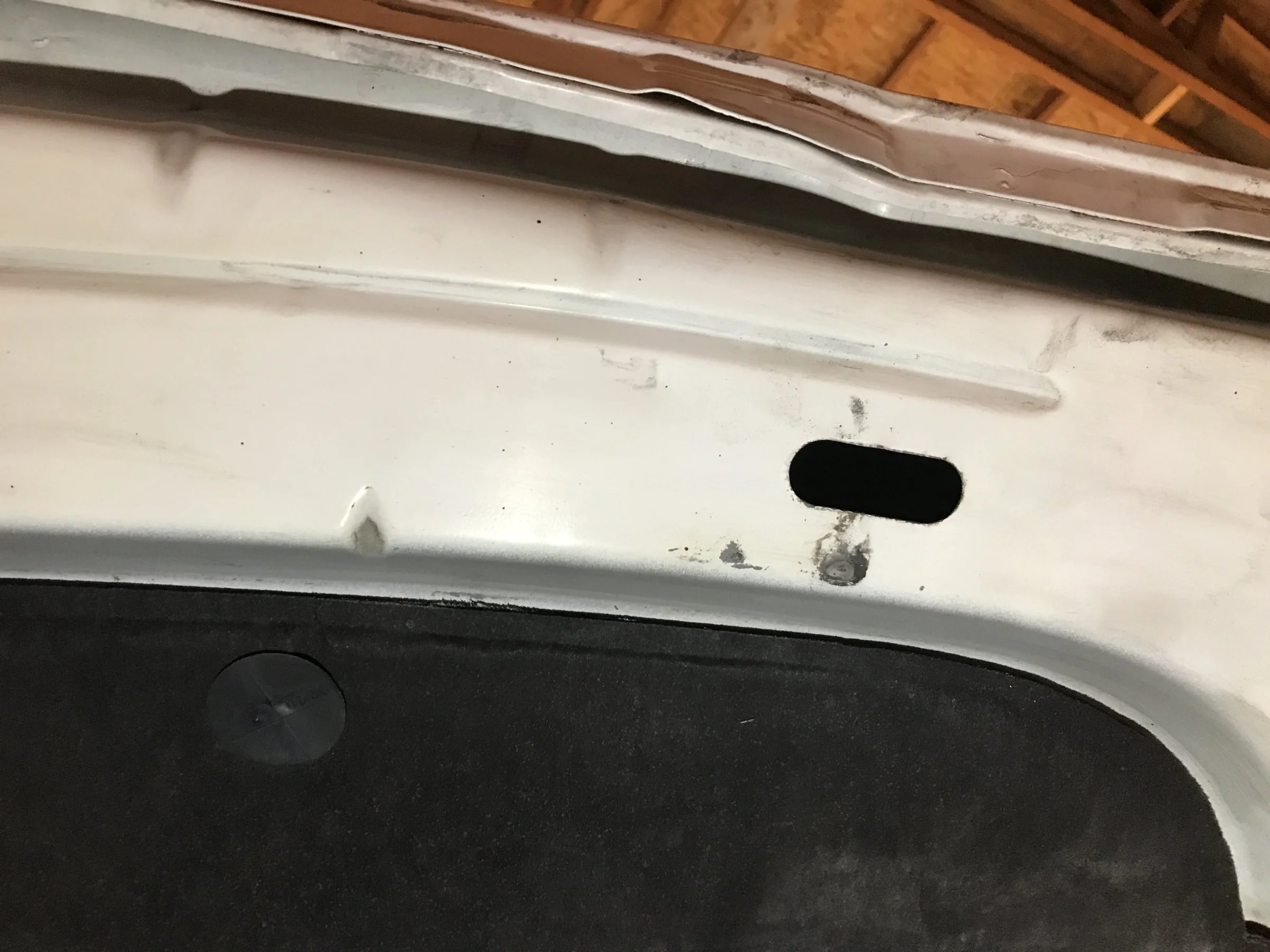

If not, some of what @Rjaaaaaa says is true. You have a couple access holes underneath that will allow you to push some.
First thing you will want to do is to pull the front end of it straight as you can. Keep checking with the gap to the header panel. You'll want a slide hammer for this maneuver.
Once you have that front line as straight as you can get it, show another picture of how it looks and I'll help some more.
OR, go to a salvage yard and find a straight hood. They should be pretty cheap. The only reason I suggest this is that without the proper tools, this can be a little bit of a pita to fix.
If you want me to call you it'll be much quicker explaining what you need to do over the phone. I'm guessing you're no where near Oklahoma, huh?
PM me if you want me to give you a call.
