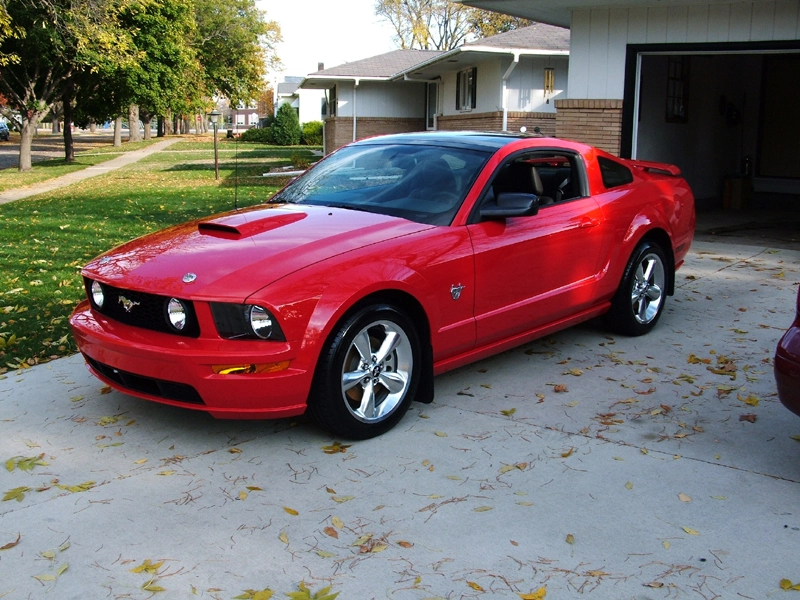

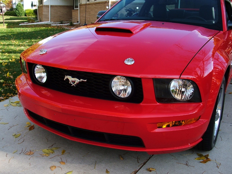

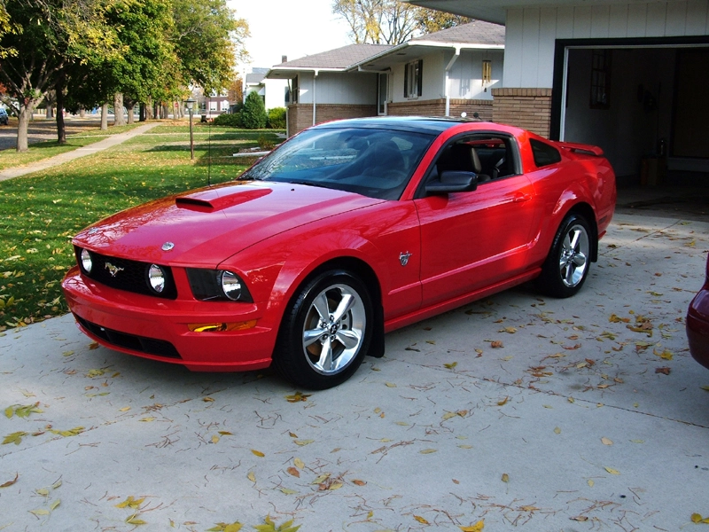

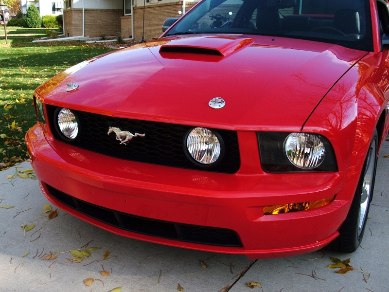

These are my Billet pins I just put on, PAIN IN THE @$$ to put on, I expected 3 hours....nope...6-7 hours.
But I love them, and I think they look fantastic.

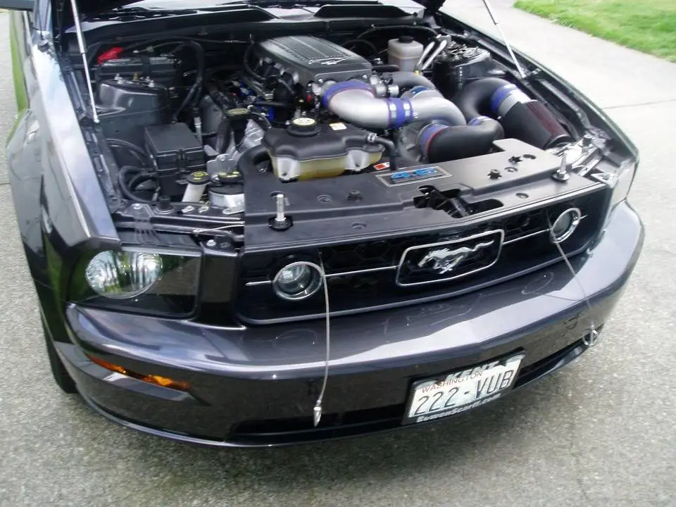

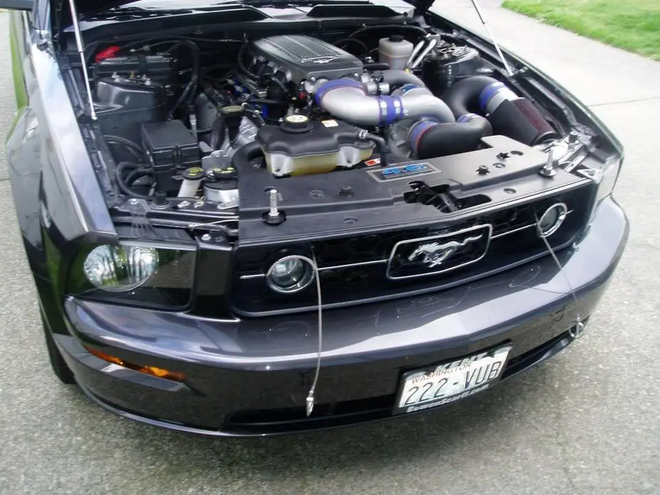

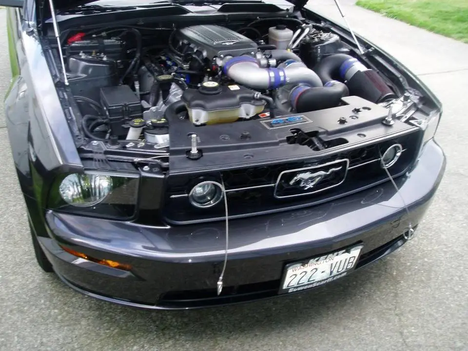

My hood used to shake at elevated highway speeds, and it was even worse at the track, so I installed the Shelby (non-logo) billitt hood pins and the shake is gone....
Fairly easy install - about an hour with basic hand tools, a drill, and a dremel.

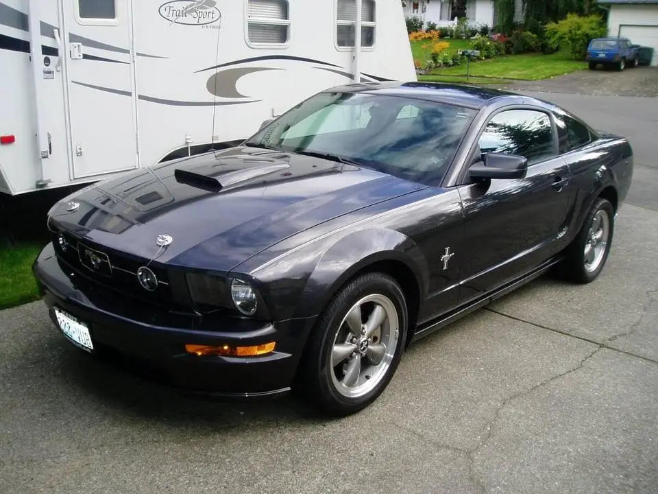

wow i love your car... at first i was like v6 looking a*& car.. then i saw the charger and had to get a towel.. sleeper for day one man i love it
Thanks, ptfoxbdy89. A buddy of mine is the complete opposite of me. He has an 06 V6 Mustang (with the Pony Package) and he's transformed it into an awesome looking GT clone and then some, but it's still the stock 210hp V6 in his car. And while I don't necessarily approve of V6's being dressed up like GT's, we did install his V6 grill and wheels on my GT to dumb mine down for that sleeper look.
I highly recommend supercharging your GT. While there are some very powerful (and very expensive) blowers on the market, I was amazed how inexpensive some systems are. I paid just $3700 for my Vortech V2, which included bigger injectors, 2nd fuel pump, programmer/tune, and all required hardware for a complete install. Also, I made sure to buy Vortech's VQ series blower (VQ = very quiet) so it makes very little supercharger whine so most people don't hear the blower - all the better to keep it a sleeper.
On a side note, I think I'm going to powdercoat the hood pins alloy gray to blend in better with the hood so people don't see them as easily (I should have just bought the black ones that Shelby sells instead - see below).
I really didn't want to put hood pins on the car, but didn't want the hood shaking or flying up either, so it's the lesser of two evils, I suppose.
