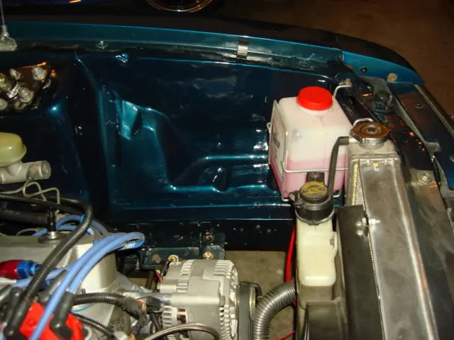

Fox will get done! I just ordered one of these.
To replace the cheap ass snow tank and to permanently mount it where the battery used to be. After this is done I will schedule the tune!

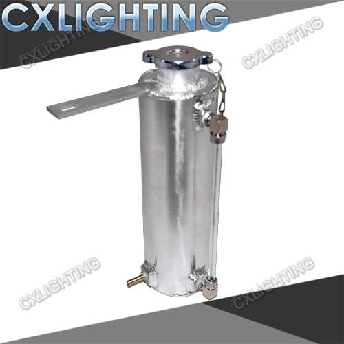

I understand your excitement, my father was unemployed for 5 months and JUST got a job and starts this week. You should have got a metal overflow tank, you can find some realll nice ones on ebay.
Something like this for 50 bucks, as long as it has a fitting on the bottom and a hose running to the radiator it ca recirculate.

mob - I wanted a different tank but both Snow and AIS suggested not getting a metal tank :(

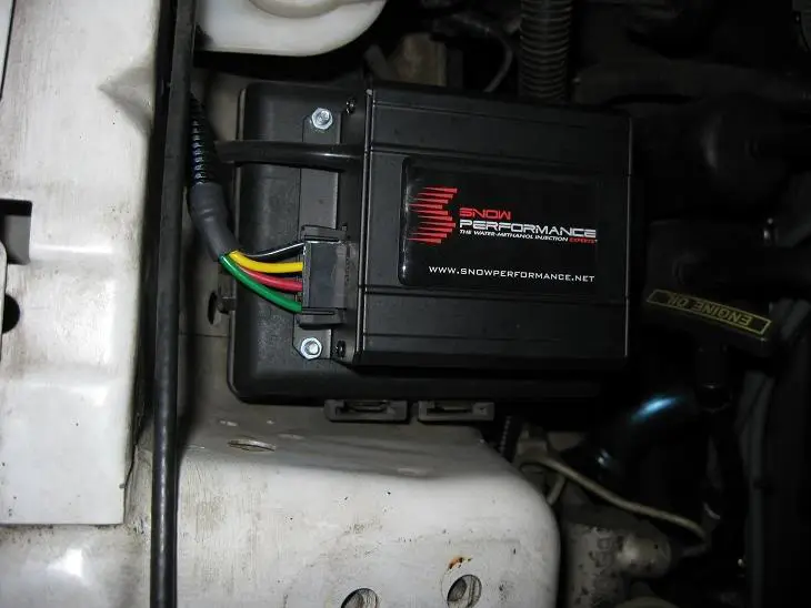

I bought a galon of it about 5 months ago and i still havnt run out lol... i have it set to come on when it hits a certain PSI. you can change when it comes through maf or boost settings on the side of the box.
About how long it lasts really depends on when you have it come on. Take a look on summit for the kit. its really not that expensive.
It doesnt help my MPG at all, it only comes on at "X" amount of boost. So if you are driving around town and not putting your foot down all the time it just sits there :D
He can chime in with when his comes on, once i get a new trans im going to start messing around with my set up more.

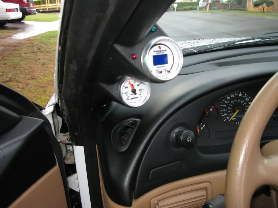

EDIT: it does start off low and as boost builds it sprays more, also one of those snowmeth kits has a safty that if you run out it retards timing a whole bunch. here is a pic of my piller gauge, on the top there is a green (turns on when the meth is flowing) and a red, the red will start to flicker a tad when it starts getting low.and then turns on solid when you shouldnt get on it anymore ;p
Here is the box, i will get another picture of it in a few minutes. with the dials on the side. i have it mounted on my fuse box ;p
