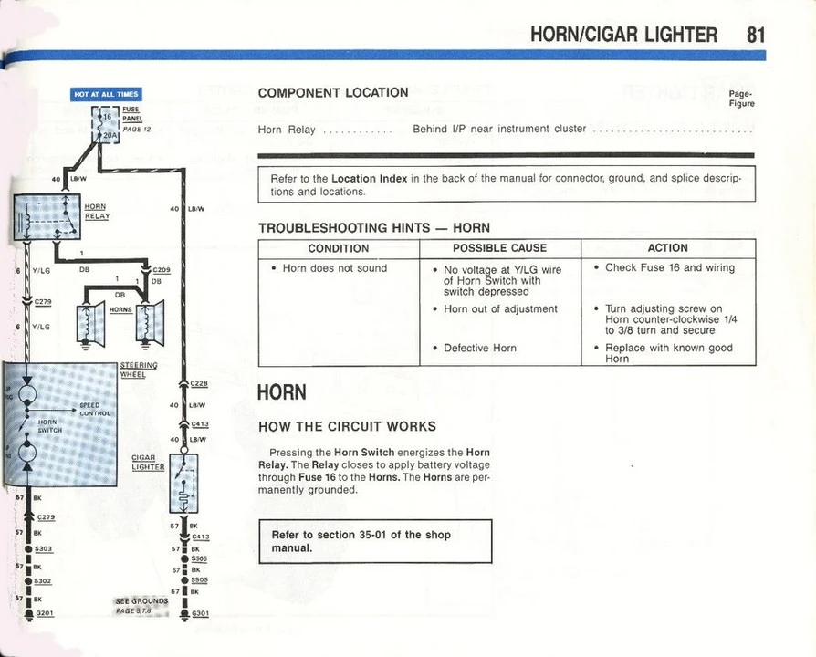

so i just an 89 gt, it has a grant steering wheel and i noticed the horn isnt working. i took off the steering wheel and saw no wires there. does anyone know the color of the wires in the steering column so i can run them to the wheel.
PM me your email address and I will send you a complete Ford Factory 89 Mustang electrical diagram set. The zip file is 2.5 MB and is too big to fit through Stangnet's email gateway.
