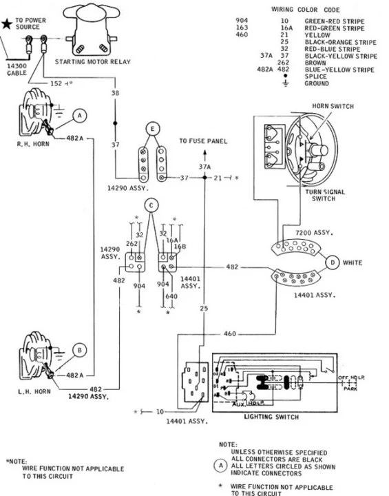

OK, disconnect both horns. Depress the horn. You should get no spark at all. If you do, the horn lead is grounded somewhere.

If you are heating up the wires that indicates a short to ground. Look at the blue-yellow switch output wire. With it disconnected at the horns, Use a meter and check for ohms to ground on that wire and then disconnect the firewall connector and then the column connector. Maybe you can isolate in what harness it is shorted and run a bypass wire in that section.

Ok, still haven't figured it out, but here is the update:
  • I disconnect the wires to each horn, push the horn and still see a spark.
  • I disconnect the steering wheel harness and with my test light, I touch the yellow wire and it lights up. The blue with yellow wire does not light up.
  • I disconnected the harness that feeds the horns from under the dask, reconnect the steering wheel harness and still have sparks.
I looked everywhere for problematic wires, but don't see any. This is the original wiring harness and it is 100% unmolested and in extremely good condition. That doesn't mean it can't have a problem, but just saying it's not a rats nest of aftermarket wires spliced in everywhere. I'm not very good with a multimeter, so will need some more details on measuring ohms. Appreciate the help guys

jcode68:
You can do troubleshooting without an ohm meter.
See if you can find connector "C". It should be a 4-way plug with the blue-yellow along with a brown, Green-red and red-blue wires somewhere in the engine compartment near the voltage regulator. See what happens when you try it with it disconnected. If it does not spark anymore, the blue-yellow wire is pinched or melted in the front harness somewhere and is touching ground. If no change, reconnect and try next check:
Disconnect the steering column connector (connector "D") and try to jumper the yellow(#460) to the blue-yellow(#482) at the harness end. If the horns work, the blue-yellow wire is pinched or melted in the column and is touching ground (my guess). You will have to pull the wheel and the signal switch to check it out.
If it sparks with the jumper, and no horn sound, the the blue-yellow wire is pinched or melted in the harness and is touching ground somewhere before the "C" connector.

Appreciate all the great advice guys. Made some progress and have narrowed the problem to the following:
I need to pull the guage cluster to get better access to the wiring harness as it is tucked up under the dash pretty well. Was a little hot to keep going on it this afternoon, maybe in a couple hours when the temps drop a bit I will get back out there and pull the cluster. Will report back when I find the bad connection. Thanks again!

Just to put some closure on this post - I was able to resolve the problem. I had to pull the guage cluster in order to access the main harness. Had a short in one spot where the insulation had chafed. Simple fix, bitch to find. Thanks for all the help!
