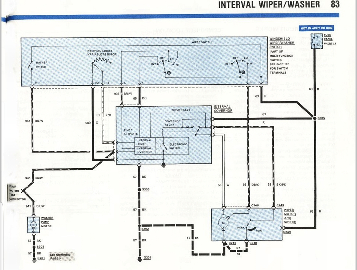

Thanks for the help! I took the dash out and started chasing wires and I’m glad I did. Found a whole mess of problems behind there. However that wasn’t my problem. It looks like my problem was where the main harness connects to the headlight harness. Someone had messed with the connector and switched the brown wire with the dark blue. Which caused my horn to go off when I hit the switch. Now, I just have to figure out my wiper problem. I get 12 volts at power but when I turn on wipers I don’t get voltage to the others. I’m thinking it might be the interval govenor! If I could get that EVTM that would be great!

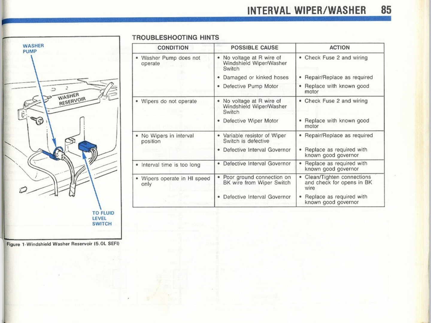

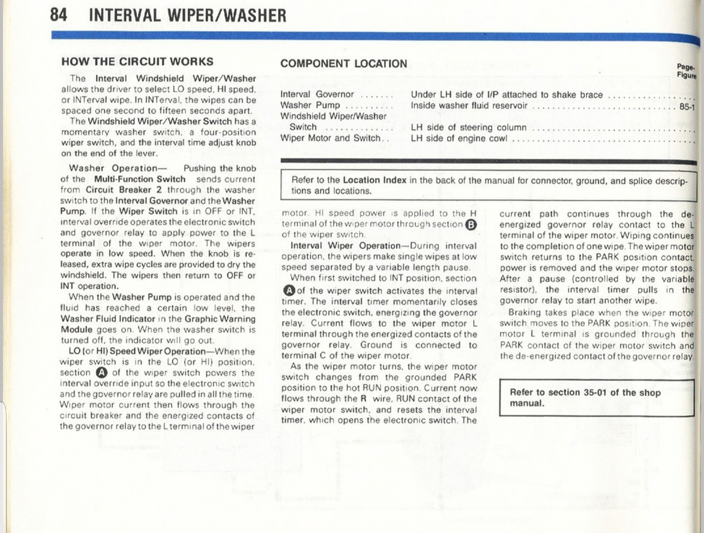

The wipers can be tricky. They should work on high when nothing else works. If not, you need to apply 12V to one of the terminals to make sure the motor works.
This is from an 88, but it is pretty much the same in all the fox bodies. The interval governor can have issues and I have repaired a few. If you pull yours and open it take some good high definition pics and I can try to see if anything looks obviously bad. There are capacitors on the board that can go bad. The other problem is one of the ground runs burning. As long as there is not too much damage to the IC's, the burnt ground runs can be repaired too. The interval governors can be purchased either new, used, or remanufactured. They can run between $30 and $130.
