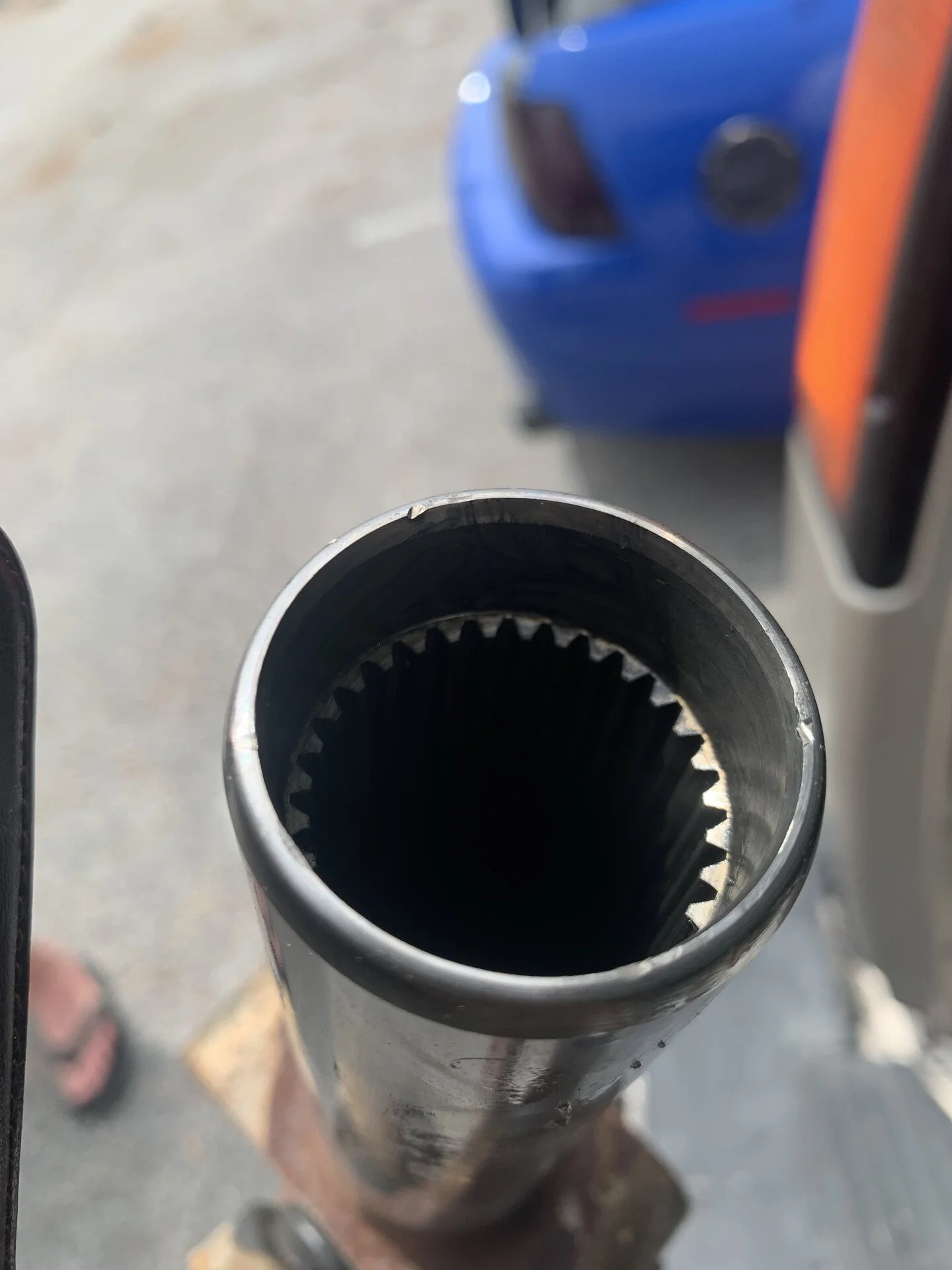

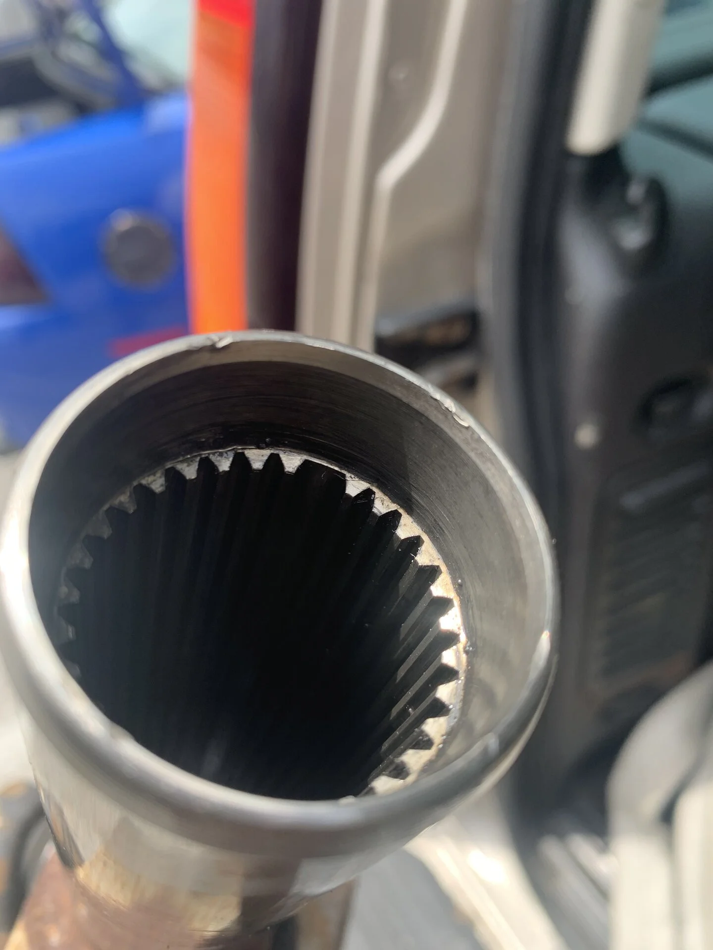

Ok, I was able to get under the car and I'm now at a loss. Nothing appears out of the ordinary, u joints seem fine. I lifted the car by the rear end and ran through the gears, there was no sound whatsoever. The sound is definitely behind the shifter, and it doesn't sound like it's coming from the rear end. There's no play in the yoke when the car is rolling. Took the shift boot off to feel the trans while rolling, I can't feel any clunking. The driveshaft doesn't appear to have any marks from rubbing anything. The biggest thing that's stumping me right now is that it makes the sound while rolling on the ground and doesn't make any noise when powering the wheels with the rear end up in the air. Does anyone have any ideas?
Well, I think it's transmission, but it still runs through gears and puts power down just fine in all gears. It did mark up the end of the yoke, any help before I rip the transmission apart?
