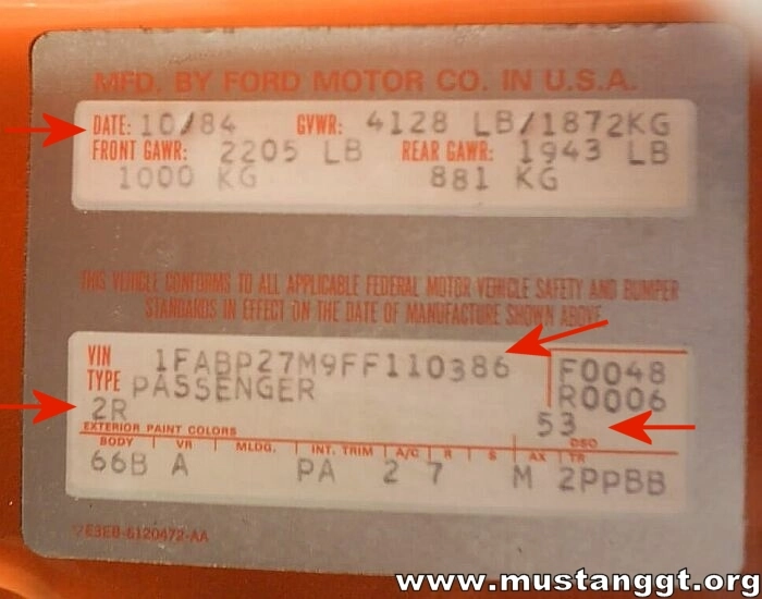

Look at the tag on your door. It should look something like this:
Note in the lower right corner is a box marked AX for axle. Let me know what the axle code is and I can tell you what ratio your car left the factory with.
