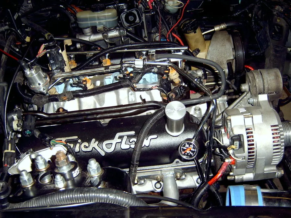

I have the instructions that came with mine, but it doesn't say which way does what. I haven't adjusted mine yet as my car still isn't running. You really should get a small fuel pressure gauge. I got an Autometer 1 1/2" gauge for like $30 from Summit (Summit also offers their own gauge for $20), and the necessary male to female fuel rail connector for like $8. Here's a pic of the gauge on my car and what my car looks like right now:

I might get a gauge, but doesn't the needle bounce around a lot making it hard to dial in?

You need a special guage that connects to the Schrader valve and no mine doesn't jump around it is pretty steady. Usually, tightening or CW gives more pressure when adjusting the FPR.
