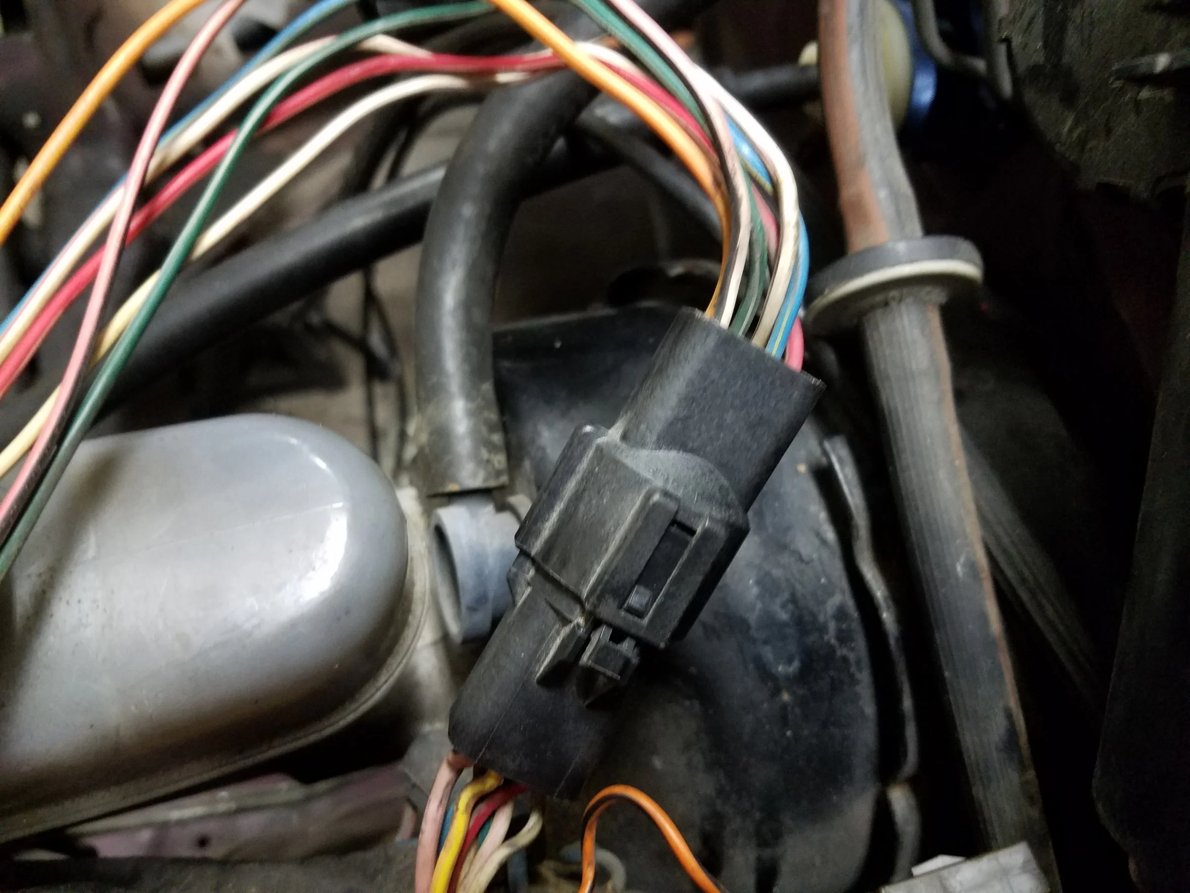

I know this is an old thread but I have a question .
I have an 89 and the black plug doesn't have a tan green wire, I did find the tan/green at the relay. can I just snip the tan/green at the relay and ground it?

Guys I'm dealing with this now. Yes I dug up an old thread but the question was never answered. I can't get my fuel pump to cut on and yes I got the car carb converted already. I started to remove all the wiring and followed the new wiring instructions up to the this black plug where it's all not making sense now. Can someone please help me please! :(
