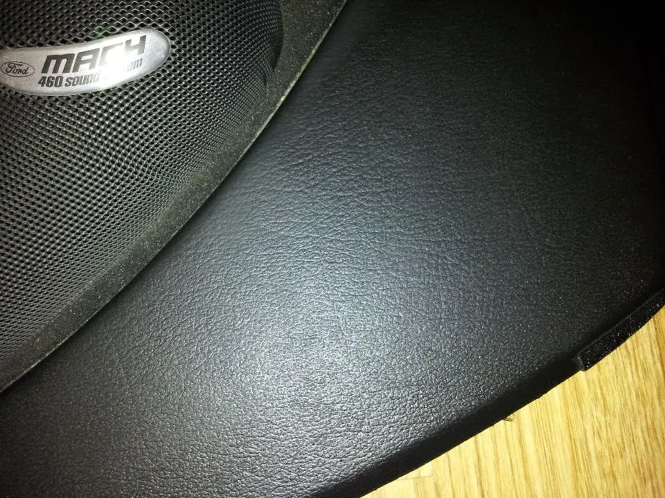

No it's definitely not plastic but particle board like you said. It must be some sort of vinyl covering on it to give it that texture. Should I even attempt to clean it or should I just use some adhesion promoter before paint?

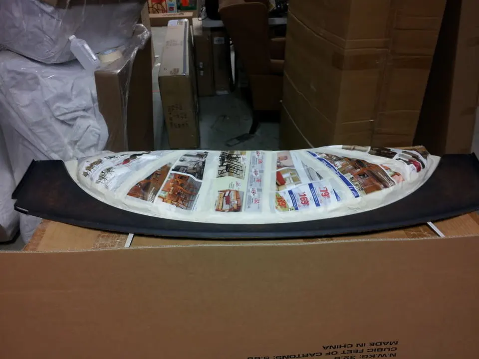

Okay so heres an update. I got the piece painted on Friday and now I am just waiting on getting some new plastic push pins so I can start reinstalling all of the interior pieces. Heres some pics.
Before:
After:

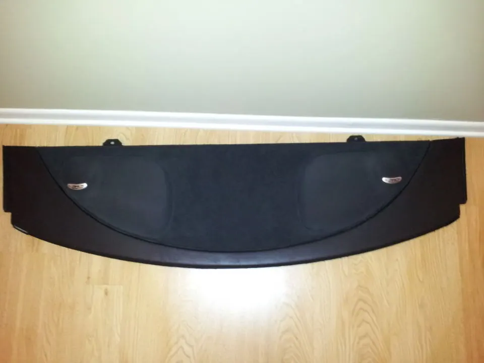

Also while at the junk yard last week,I saw 2-V6 mustangs with the Mach 460 with your style rear deck cover

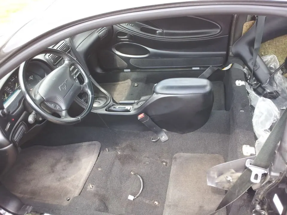

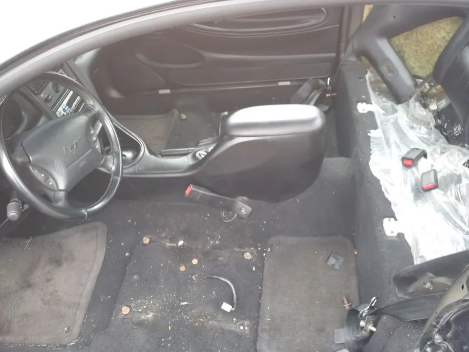

Sorry for taking so long to get some updated pictures. I have just been really busy at working picking up extra shifts and what not. Anyways here are some pics:
Decided to take my seats out to do a cleaning. Only found 2 cents
After cleaning:

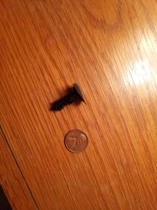

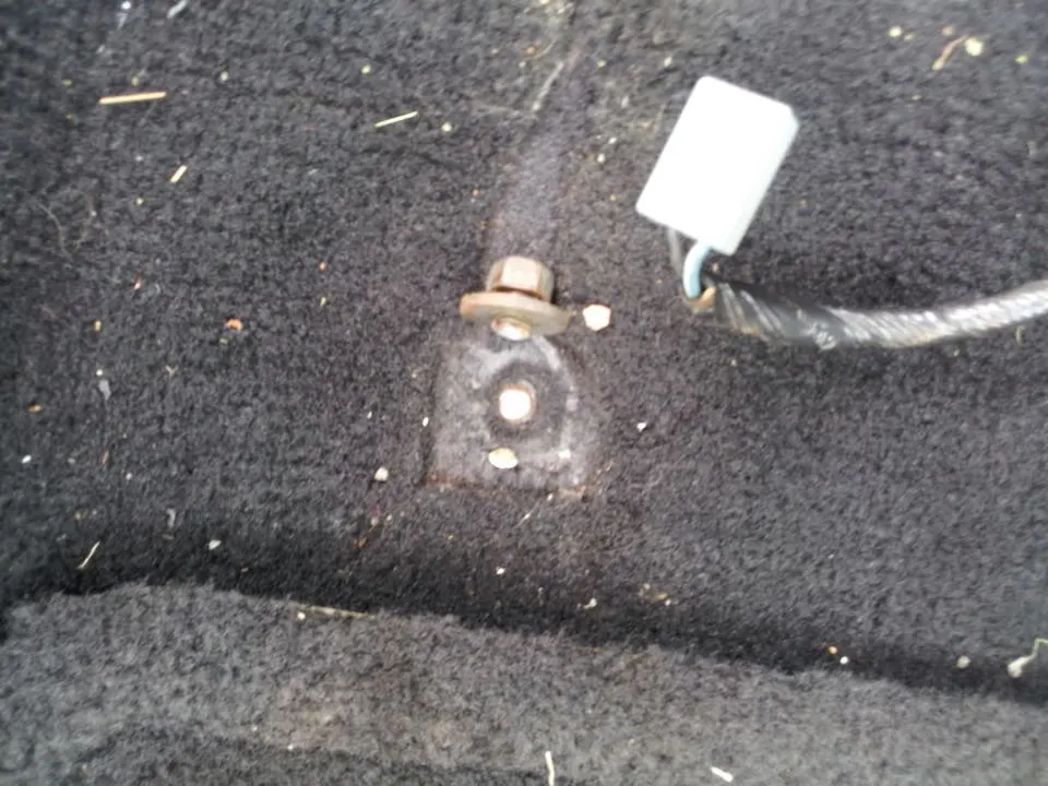

I ran into this problem that slowed me down. I broke a bolt trying to remove the drivers side seat. I had to drill this one out and retap it for the new bolt.

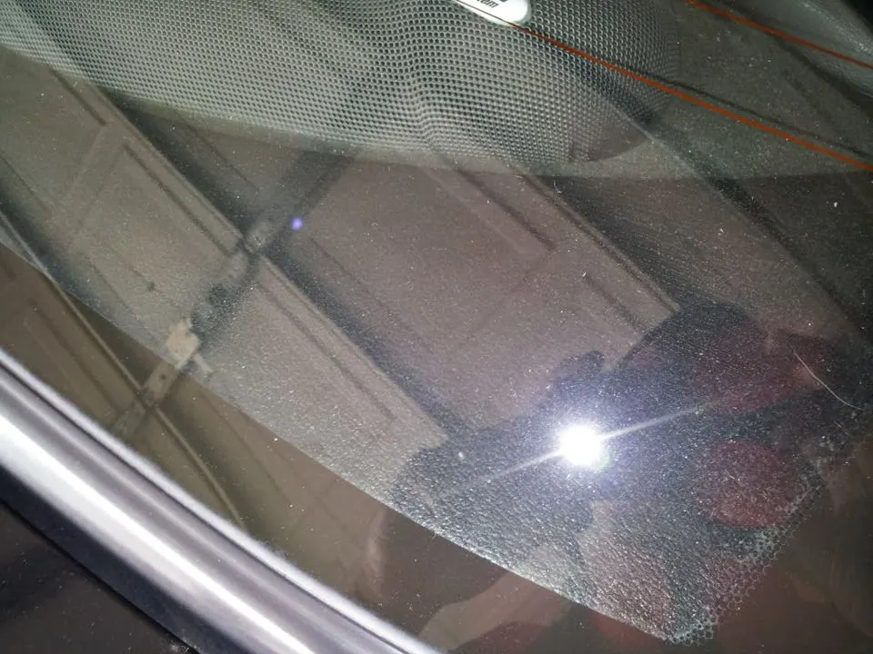

After getting the interior back together this is what the finished product looks like through the rear window (Not the best pic):
