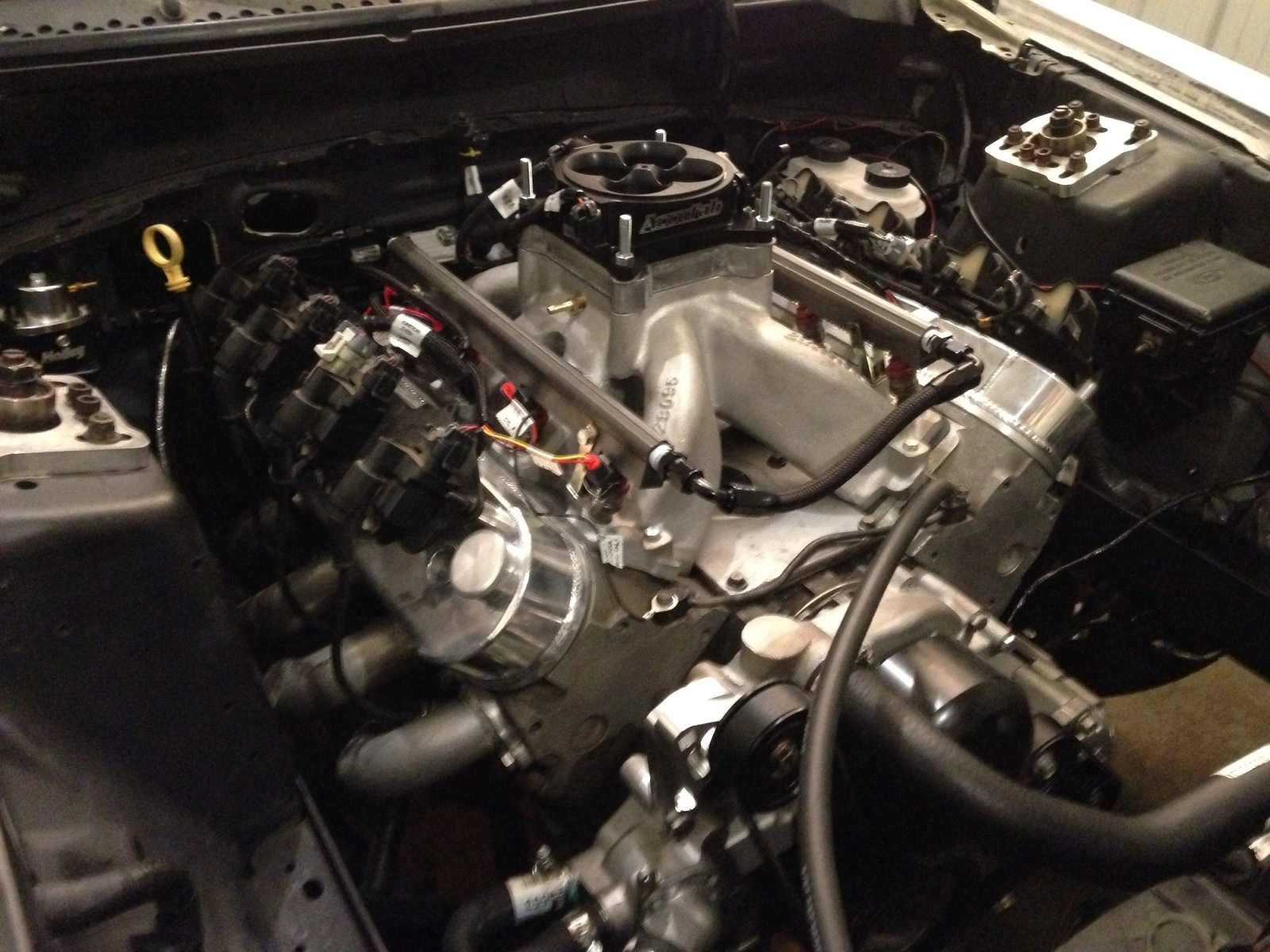

i really like these throttle bodies... with the proper lower how do they work vs the big runner upper/lower stuff everyone has?
vacuum?
drivability?
would you swap your, factory, cobra, explorer, edelbrock, tfs intake setup for one?
if you were in an 89+ fox sn95 efi car...
thanks!
please educate me !

Am I losing my mind or is this not what OP is talking about? It's NOT a TBI setup

@tannerc91gt yes, yours from the lower intake up - not so sure about the gm aspects
anyway i saw a few 1320 builds on boards and then your build,
guess im old but that setup with a circular filter and maybe shaker hood or boost would be my ideal look/setup for my 89 factory 5.0... wouldnt want to give up street drivability or upscale drivability like any normal factory plus efi/maf intake with hci would yield ......sorry if i wasnt clear...

Nope the system the OP posted is a direct port system with just the air going through the TB.

Again, this isnt a TBI system. These are much more efficient than those old systems that chevy used the heck out of in the 80-90s

Exactly! this is not some 'carb' setup its a directly attaching TB sitting on the lower, fuel rails injectors ...
or heck you could have an 8 pack of TB's !! All sitting on an efi controlled engine... but w/o maf etc
this is where i wonder about daily reliability / performance....of the design and the need for things like vacuum..
not the ecu cause thats a different debate.... i see tannerc91gt is running a megasquirt but theres a9l chips, holley, pro-m, etc... ...

Im running a holley EFI system. and while it is GM (ford fuel injectors if that counts ) its identical in most aspects.
the only issue i could see is that its way overkill for a stock 302. you can run the same setup on a performer or a vic JR and maybe pick up some drivability there but the thing is built to suck a lot of air just by design. I could see it being a real dog down low
