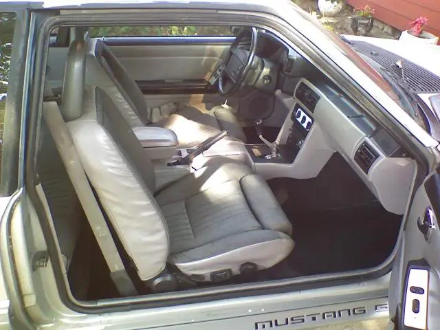

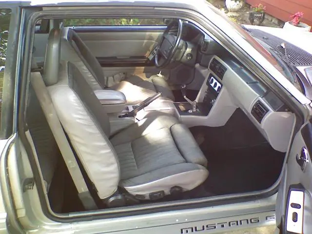

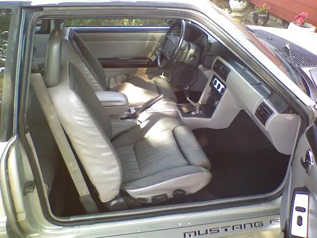

It's not a vert, but halos>stock any day of the week. The grey headrest matches the cloth part of the seat nicely, thats why I havent bothered to paint them; and I'm afraid they'll peel if I do.
