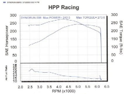

Heres mine with current mods.
Mac X-pipe and Flowmaster Dumped.
4.10 gears
Everything else stock. She made 256 / 291 with U/D pulleys, T/A and CAI.
Alright, I'm depressed now :( . I'm not sure why mine is so much lower, but I'm sure there could be many factors. I noticed your A/F steadily dropped to about 11.0, on mine it was fairly constaint at 12.5 from about 3000 and higher. Isn't 11.0 a little dangerous? Forgive me if I'm wrong, I'm still learning here :rolleyes:
Is yours an auto? I am under the impression that autos sap a bit of horsepower and torque...
The lower the number, the "safer": air/fuel equals that ratio: 11.0:1 is less air per unit fuel (richer) than 12.5 or 13.0:1. 03WhiteGT might have a few more ponies available to him if he were to dyno tune it and lean it out a tad. But 12.5:1 is fine too.
Autos do sap more power than standards, perhaps 3 to 5% or so more power.

Well, then I will live with the results. Mine is an auto, so that might explain part of the drop. I'll dyno/tune again later down that road once I replace the plenum, headers, x-pipe, cams, and injectors. I want to do a few transmission upgrades too.
