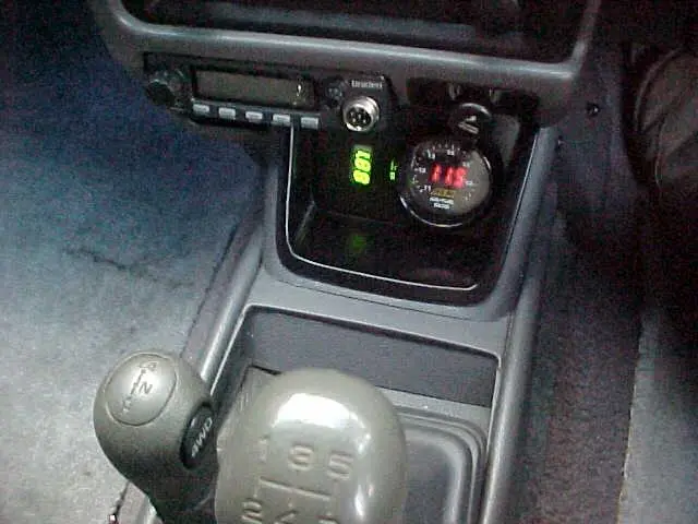

Because I only wanted to use it periodically, I fitted it inside rather than under the hood as recommended :D This is my setp with the adjuster next to the AEM wideband. Just started it for this pic :D You can see the adjusters MAF volt reading and the switch is obscured next to this panel.

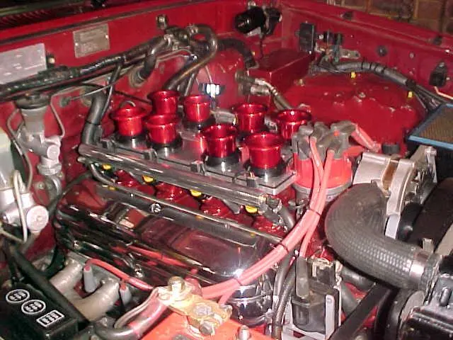

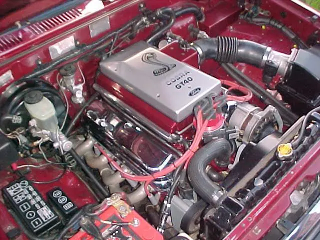

As an offshoot my engine is no slouch and its in a 4Runner, having AFR 185's, XE274HR cam etc etc and my own custom injection so correct a/f ratios are essential. But at this very moment Jay Allen is doing me a custom cam as I'm going to make the bottom section a 347 :D hence why I recently brought the Tweecer.
