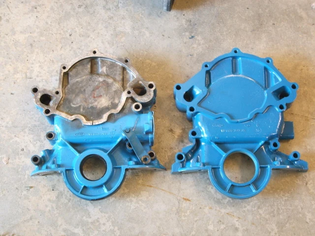

To clear the "reverse rotation" up, it means that it has a reverse rotation water pump. That motor was designed for a serpentine belt system and with the way the belt routing the water pump rotates the opposite direction. The timing cover has different water pump holes so that the water is ran the other direction through the block.
To stick with the v belt setup you will need a standard rotation water pump and the timing cover to go with it.
Here is a pic of the different timing covers, standard is on the left reverse is on the right. Notice the different water ports and the lack of a fuel pump mount on the right one.
YES! Glad to see someone who knew what they were talking about answering the question.
RMoore, Thanks for the picture. That helped.
