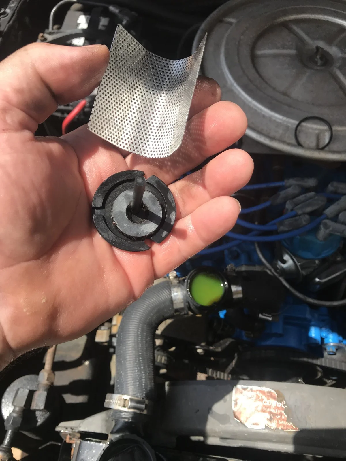

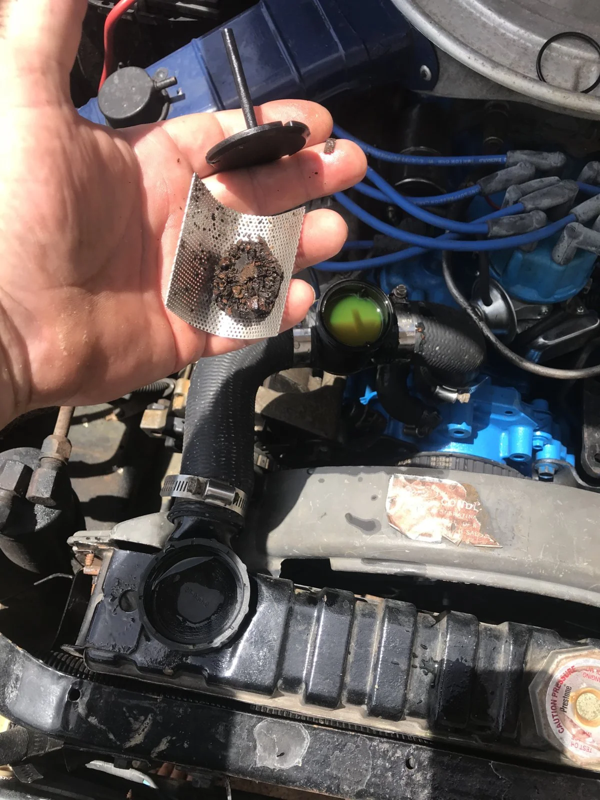

I have an old 289 sitting around that I recently reinstalled not to long ago.
That rust turd is the magnet doughnut in this tefba filter. Filter was 75$ but worth it.
I have had to clean it every couple of days for the first couple of months, but easy to do.
