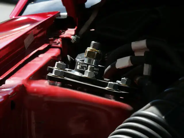

ok guys, i need some help - pics if possible. im at my buddys house and were putting them on...but it just doesnt look right. i mean the top bolt for the strut sticks up really high, its looks weird.....are we doing sumthing wrong?
please post some pics of roughly what it should look like...also please keep the size low, as he is on 56k dial up! :(
i got to get her put back together soon, i have to drive her to school tonight....2 hours
did you measure the length of the strut bolt before installing them? it should be at the same height with the new CC plates plus extra height to compensate for the lowered amount of suspension.
EG: the origional height of the strut stud (x) will change to the new height of the stud with CC plates (Z), based on the distance the car was lowered (Y)
so Z=x+y

I still think they look funny cuse they stick up...ohh well

The lower your car, the more the top of the shaft will be exposed. That's what the spacers are for.
