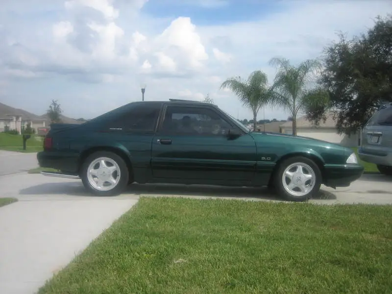

Eibach Standard(not sure which ones).Down 1.5 in front,1 in the rear.No plates,stock struts and shocks. Im well on my way to kidney failure driving this car every day. And the front wears out the inside tread on the tires within about 3,000 miles, so its used tires until I can afford to get the plates have em installed and the allignment done all in one shot. Get the plates and have it alligned as soon as you can(and go with progressive rate springs. Cutting the springs is not the right way to do it ,as it changes the load distrubution of the spring, and they will ride like ass. Mine are just too damn stiff from the factory.But it does corner well. Longpost=sorry

Here's the car the day it was bought...
1990 knee highs FTW!

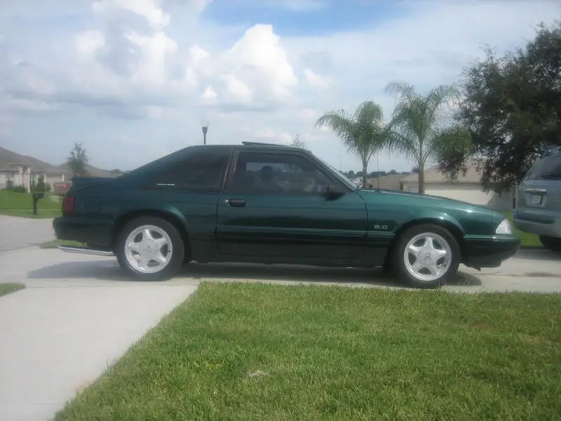

Eibach pro kit 1.5 inch drop, although the back looks a little higher than the front. I have MM CC plates and a bunch of other suspension stuff so its not just springs but you get the idea.
