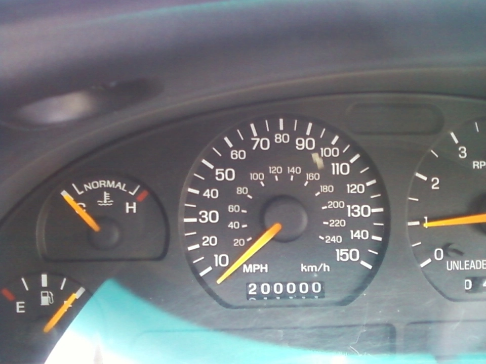

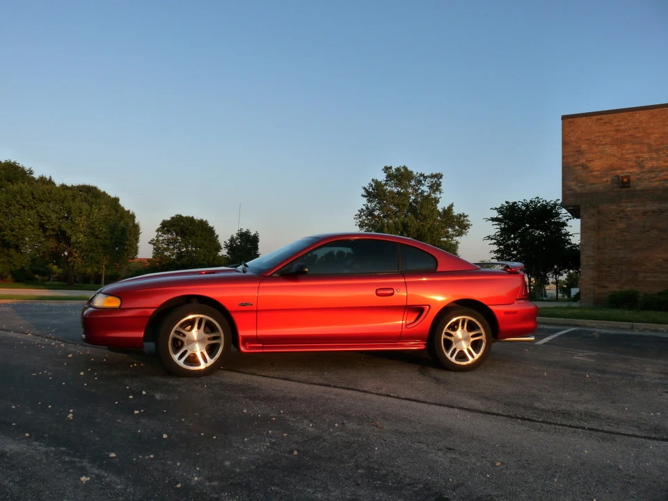

My 97 GT just ticked over 200k and I wouldn't hesitate to take it across the country. In fact, last fall I took it to Colorado and got 27+mpg in the mountains. The car still feels solid with this many miles, I even have AC! (knocks on wood).
I did replace the chain guides around 175k miles. They had some moderate wear, but it was just as much an excuse to swap in PI cams as checking the guides. If you maintain the car well, and take care of issues before they become a big problem, the car will last nearly forever. It is when people decide to stop maintaining that the major issues crop up. In police and taxi service, it is common for these engines to rack up 3-400k miles.
I personally think maintenance is more important than driving the car hard. Nearly every time I drive the car, it gets spun to red line at least a couple times. I somewhat regularly go to the track and it still runs stronger than ever.
