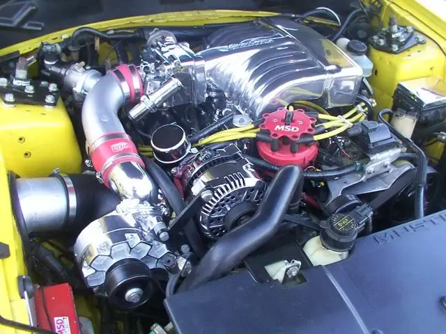

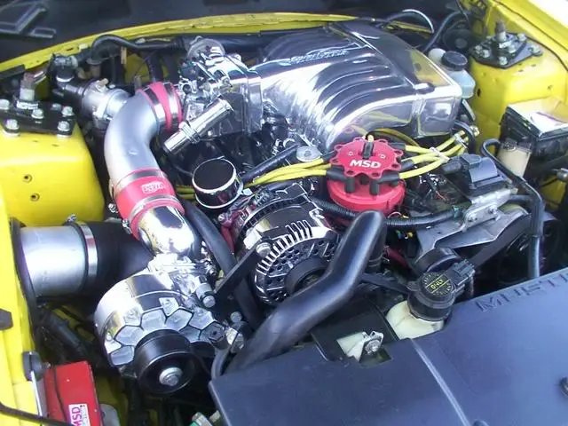

Yeah, my last supercharger build up had nothing more than a Performer intake and headmen headers and it made 425 hp to the tires @ 13 psi. If I can duplicate that number I would be tickled pink. I was very proud of that setup and I would sit and stare at it all day:
wish I still had that car :(
Anyway, if anyone looking at this thread needs a RPM upper and wants to trade I'm game. Doesn't even have to be polished!
