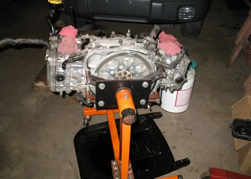

Yep, you use the back of the block where the bellhousing attaches. You will probably need to run down to the hardware store for some bolts that are long enough. Be sure that you use washers too.
Here is how I attached my Subaru motor to my stand:
