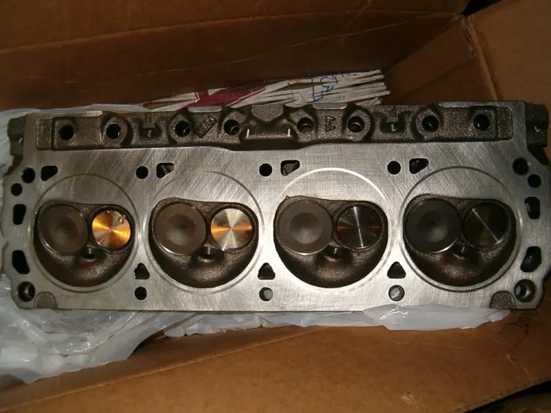

Here's a pic of the reciever grooves. 4.125"ID, 0.010"Deep, 0.085"Wide.
I would runa good MLs gasket (cometic) and see about gaining your compression with some minor head work...Your heads dont appear to have any bowl work done to them. You could gain across the board by getting them cleaned and opened up little and not los the quench by installing a taller/thicker head gasket.
