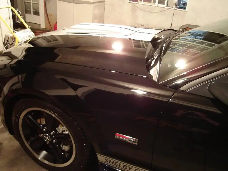

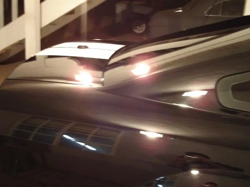

Here are the results after a year with the Shelby- and yes, it's a daily driver in the rain, mud, dirt, etc.:
