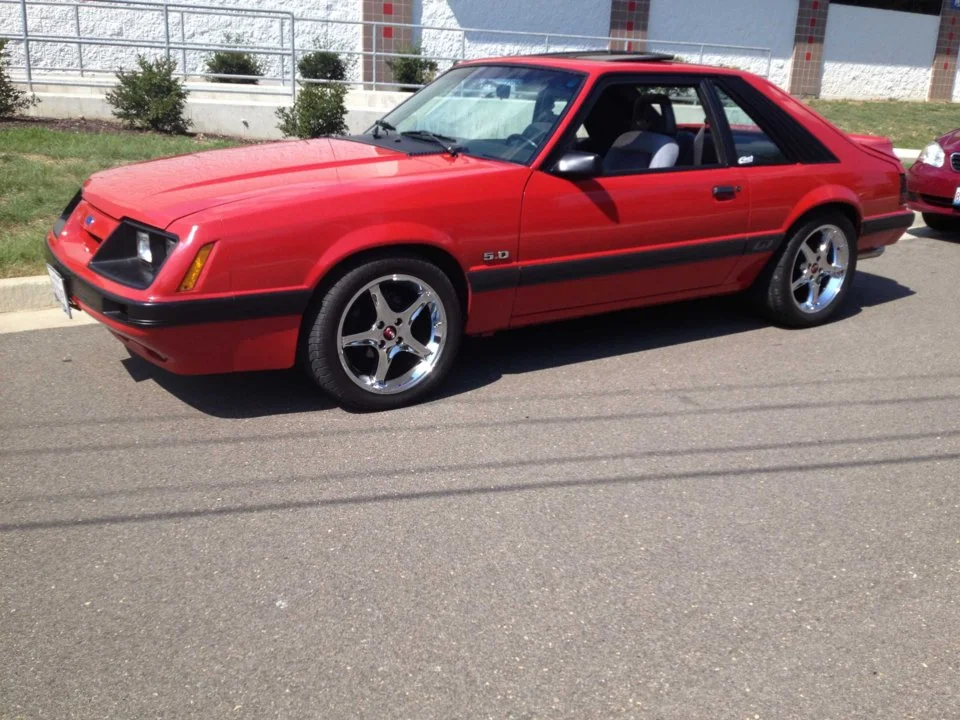

Reactions: smokin joe
This was with 245/45/17 fronts and 275/40-17 rear. 17x9 wheels with eibach springs,struts and shocks with a UPR bumpsteer kit and mm cc plates. No clearance issues
Edit: with 17x8 keep the front tires around 245/45 or 235/45 and you'll have plenty of room. It's a very common size. I highly recommend getting some cc plates and the UPR or steeda bumpsteer kit. It really helps with alignment and allowing the front end to not "jump" around with bumps in the road etc. That can be a problem with lowering springs. I have since gone to coilovers and even lower frontend without a problem. I am going to raise it back up a 1/4" or so for a cleaner level look.
