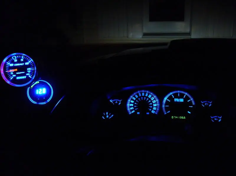

Here's the pics of my tri-LED set up on a Mach 1 gauge cluster. The red needle doesn't light up enough for my taste but oh well. Overall I like it.

Yes. In the pics, you can't see the needles at all. In person, you can see them a little, but not much. I actually got pulled over because there was a cop behind me and I could have sworn I was doing 50 in a 45 but nope it was 60 and I got a ticket. So most of the time it doesn't bother me, but really the needles are not bright enough to be of use at night, at least not of safe use. If you really stare at the gauges for a couple seconds you can see how fast your going but by then the po po's got you. I'm not going to change it because I'm used to it and I invested so much time and $ into the bullet cluster and stuff that it's staying but my advice to others is to try another route. Good Luck.

This is exactly what I went through. Then I bought Mach 1 gauges. Tried bulbs, LED's, all kinds of stuff but as you can see from my pics from above, it didn't work out all that well. With all the money I dropped on this project I should have just bought custom made speedhuts or something. I still don't understand how Ambo got his to work so well.

I like my Mach cluster just because it's a Mach cluster with the old school numbers and stuff. I wanted one whether it was blue or not. So for me it was worth it. Now as far as the blue LED's go, I don't think they even work in the Mach gauges. It doesn't light up the needle, not very well anyways. It's tough to see at night. I'm going to try white LED's with some blue plastic wrap stuff over the back of the cluster. At least that's my latest idea on how to get blue with a visible red needle. It probably won't be anytime soon becasue I want to get my built engine in, but when I get it done I'll let you all know how it goes. I would say if you can save up some money, and you like the speedhut gauges, just go with those. I'm a do it yourself guy and I like learning from mistakes. So I'm gonna keep sinking money into this until I get it right. Good luck man.
Hey guys, just got back from my house doing my LED install and helping a friend with some other automotive fun (painting calipers). Anyways, I was trying the white lights. I got all the lights installed, though getting the old ones out was a bitch, and got it wired up and turned it on. To my surprise I was greeted with a blue cluster. Turns out the gauge faces are tinted blue, so I pried off the gauge faces, unfortunately causing some small tears in the faces, but mostly covered by the needle base. Then I took some steel wool and took off all the places that had blue on it on the back... a very tedious/painful process but worth the results in the end! I'll post pictures soon, and then I still have to install my HVAC's. I still need to adjust my temperature gauge too.
Hey guys, here are the pics. I put in the HVAC ones right now and unfortunately I couldn't figure out a way to take off the middle knob and was unable to take the face off to sand down the back... so I'm stuck with blue in the middle (for now).
